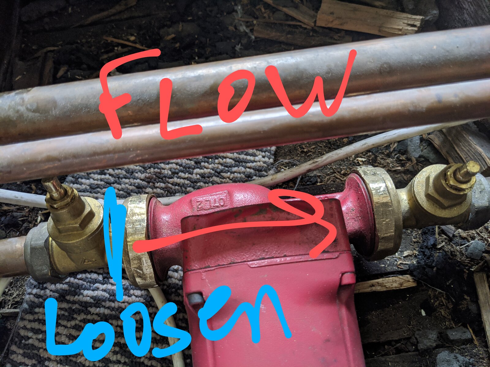

Hi all,
So since moving into this house my heating has been very tempremental in that the pump (grundfos alpha 2) seems to be getting airlocked all the time.
It's an old vented system with its own feed from the boiler going to the central heating pump (so no switching valve etc).
If I've not had my heating on for a day when I next fire it up the radiators don't get warm and then I look at the pump and even put the pump on the highest setting it's operating at 11w max and struggling to push the hot water around the pipes. The boiler then stops trying to heat the central heating and goes into a loop of firing up for 30 seconds then stopping.
The only way I get can it to fire up properly is if I then loosen the nut on the inlet pipe to the pump (blue in the pic) and let out a massive amount of air for 10 seconds or so, then if I put the pump on max it'll shoot up to 45w and all my radiators eventually become hot. The problem is if I turn the heating off for a few hours and fire it up again, the pump (or just before the pump) seems to be airlocked again? Then I have to follow the same procedure.
Not a problem right now whilst I have the floorboards up (pump is annoyingly in the centre of the back bedroom under the floors) but eventually I'll be redecorating and need to lay carpet etc.
So I'm wondering if anyone can help me diagnose how this air is continually getting into the system? Can try answer any questions to explain further if needed
Pic attached , thanks.

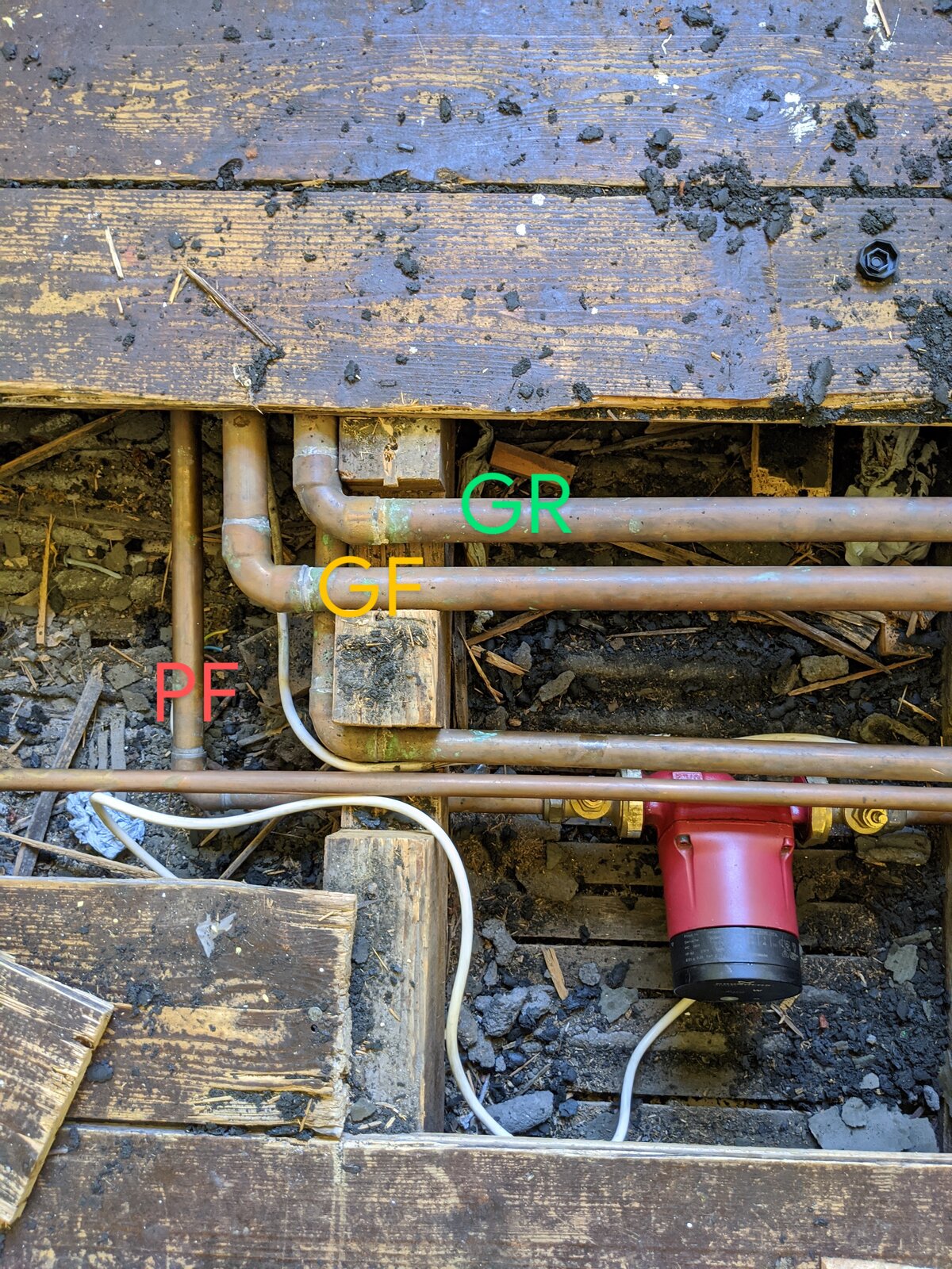

Boiler make and model and a diagram of the pipework needed.
It's an old baxi solo 40/4 RS. Pipe feeds below:
