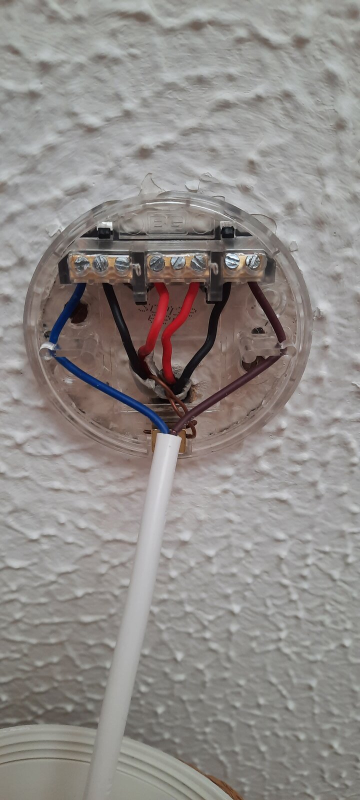

I recently changed a couple of ceiling roses for a newer ones that weren't grubby and yellow. I noticed something odd... in the fact there was only 2 cables going to them.
In previous houses I have lived at, there has always been 3. 2 which form part of the ring/circuit, and one goes to the switch. Im wondering, how on earth are the switch operating these lights?
Anyone have any ideas? I mean, the switches work, so something must be happening somewhere!
Nothing unusual - red / black pair to the left is the feed, and the pair to the right is the switch leg.

Makes sense, but how would it then continue on to the next ceiling rose in the circuit? Would there not need to be a feed out?

could be the last rose on the circuit. (say if you change ones upstairs and 1 downstairs)
or there could be a central supply or junction in the loft
Lights are not normally wired in a ring, just a straight radial. So there has to be an end one somewhere. Looks like you've found it!
