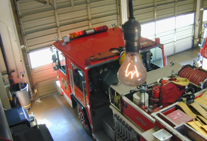

There will always be the exception to the rule, the fire house bulb over 100 years old (although now so dim can't be used as a bulb) or the bulb which fails within minutes of turning on. The GX53 1727943235968.pngmethod seems good, swapping a bit more than the basic bulb, but can still swap the lamp in minutes, but what about some thing to replace the 2D lamp, or fluorescent tube in general. What non integral options are there, which are not restricted to a single make of bulb/tube?

There will always be the exception to the rule, the fire house bulb over 100 years old (although now so dim can't be used as a bulb) or the bulb which fails within minutes of turning on. The GX53 View attachment 357670method seems good, swapping a bit more than the basic bulb, but can still swap the lamp in minutes, but what about some thing to replace the 2D lamp, or fluorescent tube in general. What non integral options are there, which are not restricted to a single make of bulb/tube?
