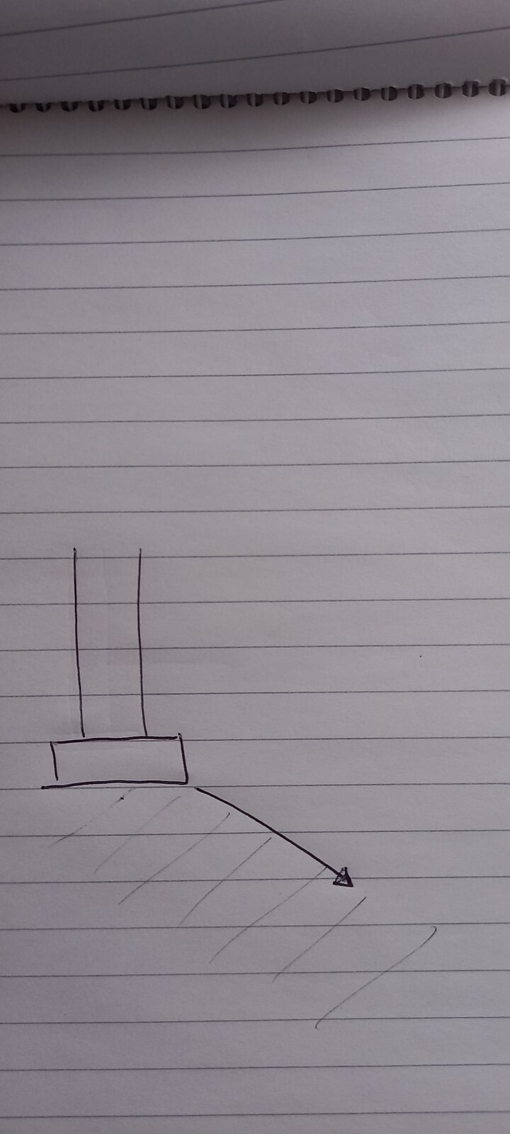

I've been told by a builder that they always aim for a 45 degree line from the base of footings to any trench, such as for drainage. Why is this necessary when it doesn't matter how much soil or other material is up against the side of the foundations?

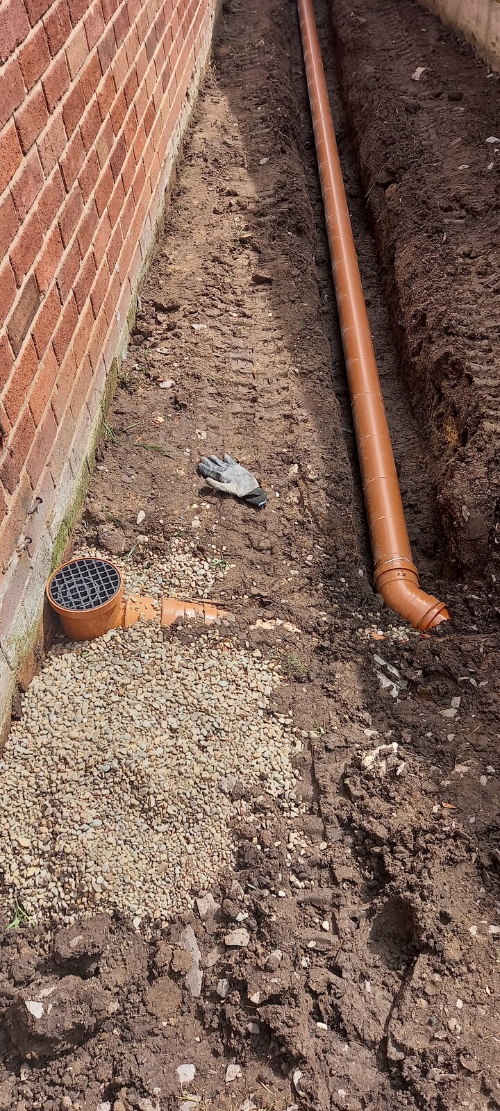

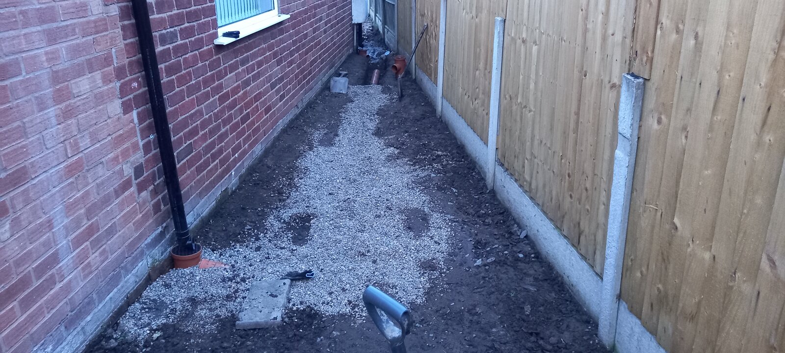

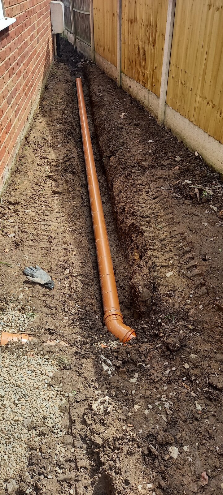

I've had this drainage pipe installed down the side of my house to remove excess surface water from front garden to rear garden area where it drains much better. The pipe has some perforations in the top half to also collect water from down the side which would get some pooling in rainy conditions. The bottom of the trench is probably 6 bricks below dpc at the point nearest on the photo, going up to about 4 bricks below further away. The trench was filled with pea gravel, membrane over the top, and finished in a few inches of gravel, the top of which finishes 2-3 bricks below dpc from one end to the other. The trench will get water in it when it rains although the pipe will carry some of that away if it fills up...
is any of this likely to be a problem for the house, foundations etc?

The weight of the building is transferred to the ground from the base of the foundation at an angle of roughly 45 degrees, known as the angle of repose.
Thanks Stuart, that's interesting. I'd misunderstood what he meant then I think. So is the angle taken like in this image, so that you don't want a trench in the shaded area? Presumably becomes of less significance after a certain distance.
