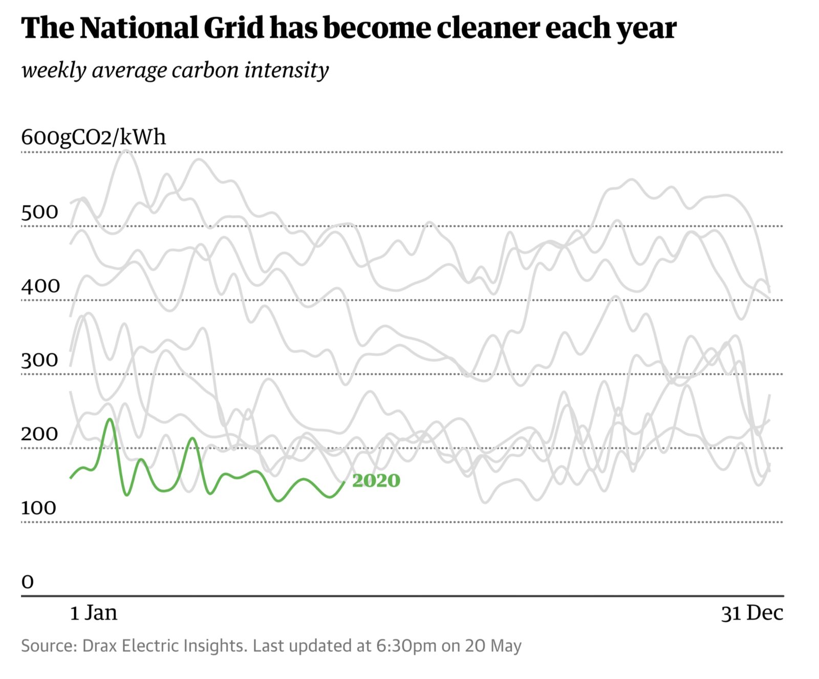

We’ve just passed the point where heating with electricity produces less CO2 than heating with gas; I think we can expect to see gas prices rise and electricity fall (relatively) to encourage less gas use.

The largest energy source for UK electricity generation is burning gas.
Yes, the largest source is gas. The rest is nuclear, wind, hydro or solar. So the average CO2 is below that of gas.
(We now get only a tiny amount of electricity from coal.)
Only true if burning gas to generate electricity was 100% efficient.
In reality it's grossly inefficient. 60%+ of the energy is lost before it gets to the end user, so for every 1kW of electrical energy delivered, 2-3kW of gas is burned.
https://www.theguardian.com/busines...-breaks-record-for-coal-free-power-generation
https://electricinsights.co.uk/
Electricity being used right now produces 147g of CO2 per kWh.
That compares with more than 500g in 2012.
It’s currently 30% gas, and virtually everything else is carbon-free.
Burning gas to produce electricity produces about 400g of CO2 per kWh of electricity.
Burning gas in a domestic boiler produces about 185g of CO2 per kWh of useful heat.
