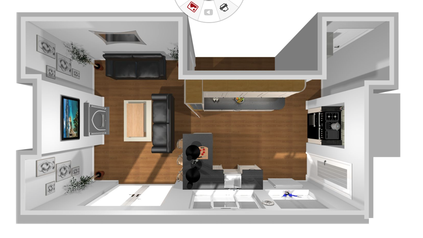

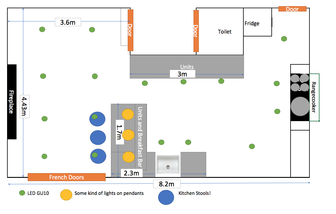

I'm thinking of getting LED downlighters fitted when the kitchen/diner is refitted.
But I don't want either LED overkill or, conversely, pockets of light and areas in shadow.
I have attached a diagram made by me to show where i think the lights should go (after reading various web pages) and hopefully a diagram of the kitchen installers mock up.
Is this the right thread or is there some kind of design thread I've not seen?
How much should I be spending per unit? I don't want to spend a fortune but I don't want to buy cheap and having to get units or bulbs replaced on a regular basis (seems a common occurrence, either people are very happy or are constantly replacing stuff).
Taking the above into consideration. Is it a realistic to want reliable dimming LEDs? or is that still a pipe dream on a reasonable budget? With it being a kitchen diner I would quite like good well lit working environment and a more relaxed chill out/eating light scenario.
Probably 2 main circuits. One for the kitchen area and one for the dining area and a separate light circuit for the pendants above the breakfast bar.
Any light placement and dimming advice greatly appreciated.

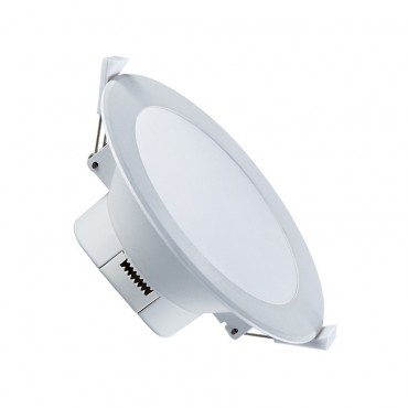

I did assume that you are talking about using lots of small diameter recessed downlighters. Recessed is not the problem - small is. Use recessed lights in the 150-200mm diameter range and you'll be fine.
Aurora are a good make.
Or rectangular LED panels let into the ceiling so that they are flush.

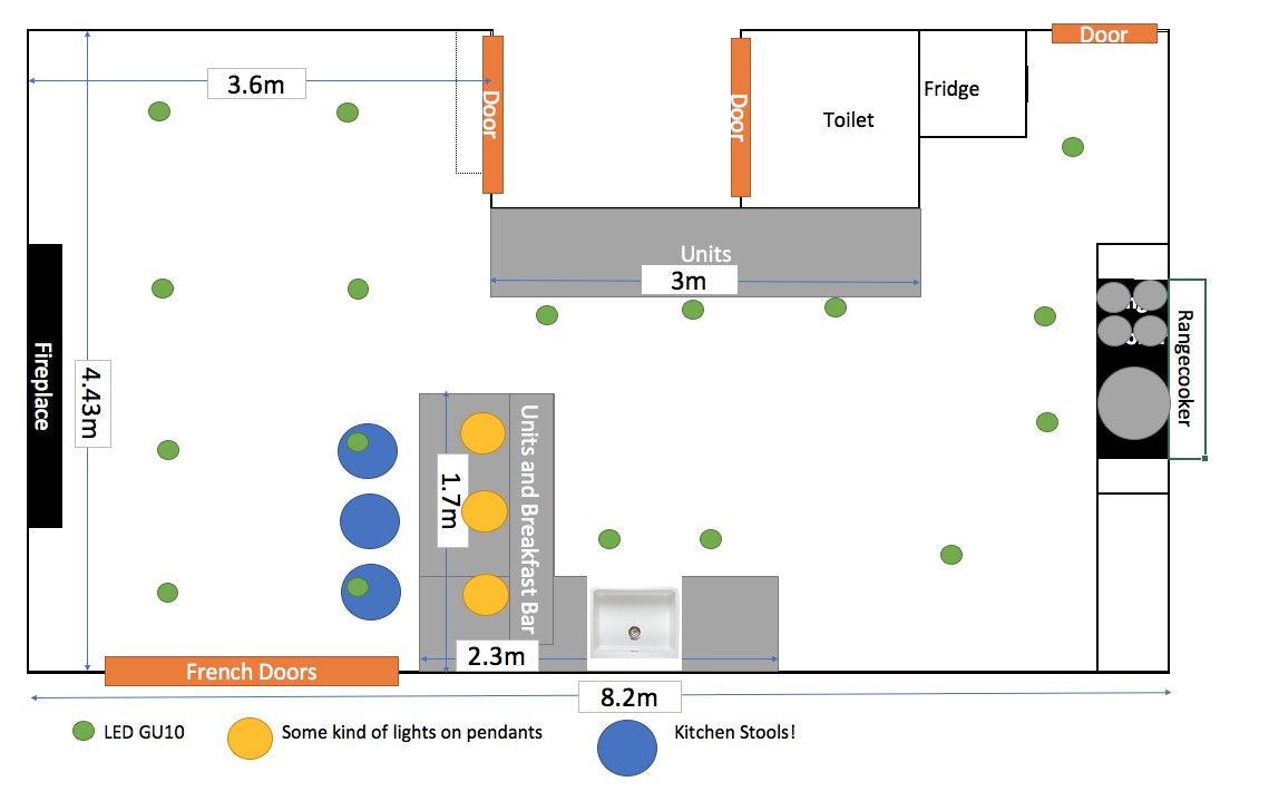

I like downlights myself, looks like you’ve got somewhat the right amount of lights but no matter what you do. Keep them all in straight lines.
As drawn, you’ll hate them when they’re off.
The lounge area is fine, but the kitchen will look like someone threw darts at the ceiling and fitted a light where they stuck.
If you can get the 4 along the cooker wall in a straight line do, if you have to dog-leg the one by the fridge, that’s fine.
Then get the 4 along the 3m unit wall in a straight line, ideally in line with 2 in the lounge but not critical.
Then the three above the sink in a straight line and evenly spaced.
Your plan may and probably will change as per the joist layout and spacing but you’ll have to play it by ear.

Area of light matters, this
is a down lighter as well as your touch size GU10 types but the area is around 7800 mm² where a GU10 by time to count for room needed for cooling fins is around 950 mm² so the ones requiring a 105 mm hole have 800% more area of light emitting surface.

Do you really think that placing a TV above a fireplace is a good idea?
The best height for a TV..........
Wow thanks for that insightful comment on my LED question (y)
Thats a kitchen designers interpretation of the dining room. I have no idea what will be in that part of the room yet, probably a lazy sofa and a dining table. But defiantly not a tv above a fire.
