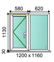

Hi,
Just getting a quote for some replacement windows, all 2 pane, one opening and one fixed.
What’s recommended, 1 or 2 trickle vents.
Have seen some with just one on the opening window but should I be getting 2?
Many thanks

Thanks, If you had the choose though would you go for 2. Is that preferable?
Yes. You can shut them when not needed. If you don't have them, you don't have the option.
I'm in favour of ventilation.
1 or 2 vents?
Like JohnD said I am thinking 2 would be better

Can they be put on the non opening window as well?. usually they are just on the opening one as well.
So is it possible to have one on the opener and one on the fixed side?
Will go back to the company but just want to be sure I know what I am talking about.
Apprently to have 2, I will need to have,
In order to have two, you will need a larger head and a packer so you dont loose the trickle vent and they can operate correctly.
Does this ok, correct and worth going for?
