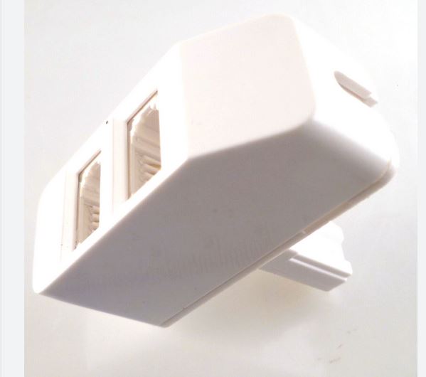

I have an long phone line from the BT socket to the living room and years ago when I installed it I had to cut off a bulky 2 into 1 adapter on the end I cut it about a metre from the 2 into 1 I then just twisted the wires back together and put some tape on it.
But now I am about to have FTTP and the phone will now plug direct into the router for VOIP - so will it work with just using the 2 wires as like now.
Its hard to understand what your saying, but yes its only two wires for a phone line to work. Sounds like you are back feeding the living room from the router which will be fine, I'm sure the engineer will make it work if you give him a nice cup of tea and some biscuits and maybe a something with the queens head on lol.

If it's a VOIP phone plugged into a network socket on the router, it's a network device like your PC is and needs a proper network connection (could get away with using 2 pairs of a 4 pair Ethernet cable but 4 core phone wire wouldn't work because the cores aren't twisted and interference between cores would kill Ethernet's ability to work)
If it's an analog phone and all the VOIP circuitry is built into the router, the phone can work off 2 cores back to the router and they don't need to be twisted

The phone wire is 4 core but I only connected 2 back together after I had cut it. I cut it to pass the bulky 2 into 1 socket adapter through a hole.
A small issue now is that the 2 into 1 is a bit big to fit into the bottom of the router but if I put a new single BT plug on the end then which colour wire gos where in the new plug.

I am not referring to the external cable here - as in the one that comes into my house from the post across the street. This cable ends at the BT master socket near the front door. But my main base DECT phone is in the living room so I just go a length of extension cable that happened to have a 2 into 1 plug on the end which I plug into the BT socket and it is that cable that I cut and only used 2 of the 4 wires which are solid wires.
It looks like this but is hard wired so i cut the cable further away. The only reason i used it is just because that is all I had at the time and it worked but the 2 into 1 that you see is a bit big for the router socket position which is right at the bottom of the router.
My new router, has an RJ11 socket. The installer, offered an RJ11, to standard BT socket, before he left..
Mine has the standard BT socket - fine for a single BT plug but mine is that silly 2 into 1 thing and the router doesn't sit properly. Maybe the fibre man can fit me a single plug on the end.
