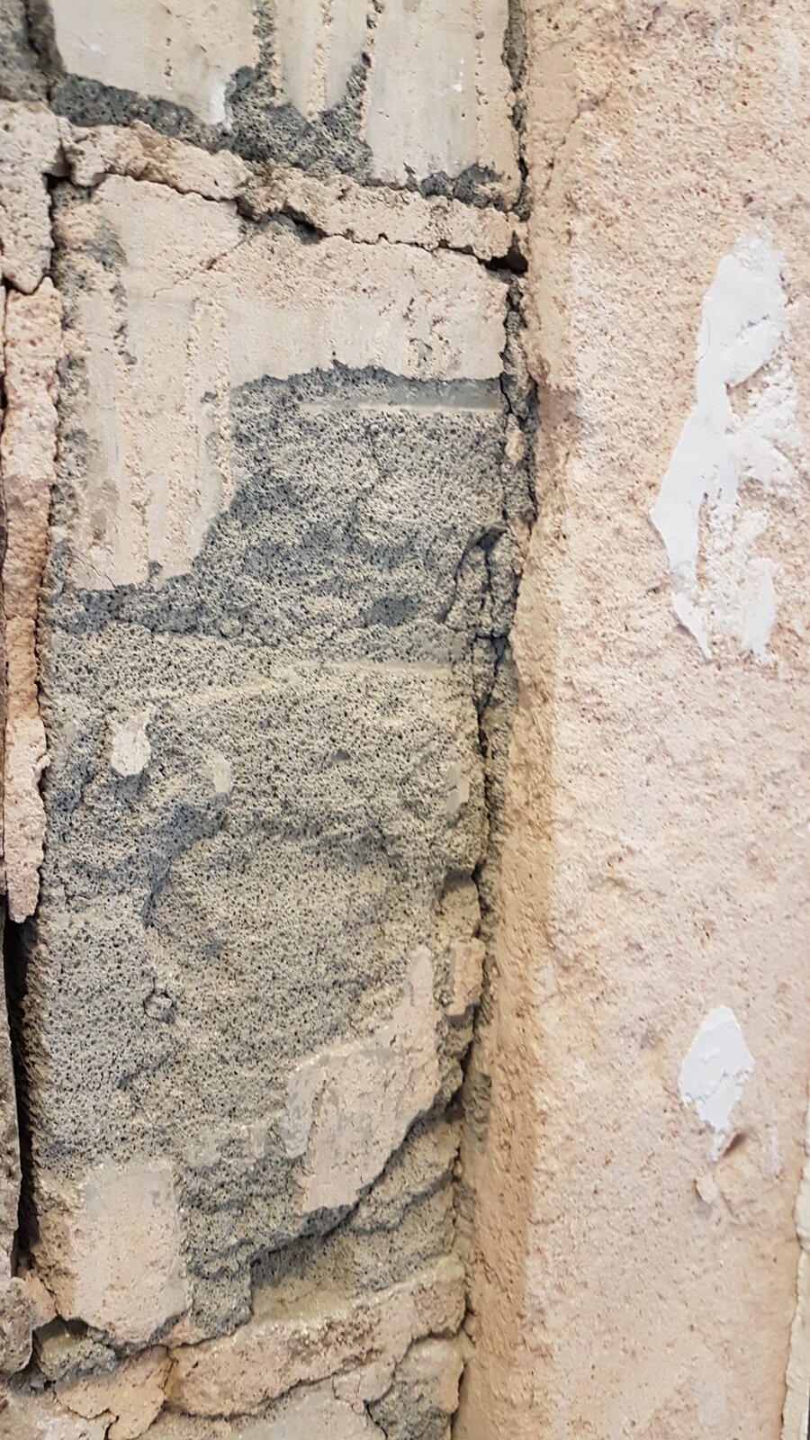

I'm doing the same job, which bonding did you use? Trying to use the same stuff on the breeze blocks
I'm using bonding 60 and easifill 60. I've no clue whether or not it's suitable for breeze blocks. If there is a risk of moisture coming through it might not be suitable as it can absorb it.
If it's an exterior wall with a risk of damp then a lime based bonding is recommended. But keep in mind that I'm just parroting what I've heard on youtube videos and have no expertise myself :D
