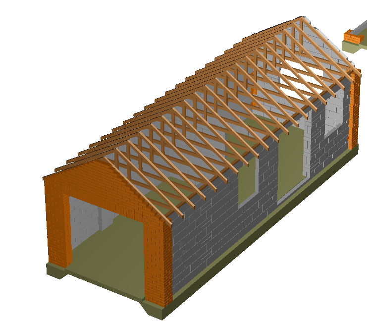

I'm not going to estimate yours, but here's my actual costs so far on current project which is similar building 9x3.3 (garage/workshop) and currently up to wall plate. Doing everything myself (so no labour)
Raft pad/foundation ~8 cubes of concrete, + sub-base materials, reinforcing, digging out etc ~£2K
Bricks, blocks (for single skin block with brick front aspect and brick corners) + sand/cement etc. £1.7K
Trusses £650
Slates and all associated roofing materials £2.2K
Cembrit plank cladding £1.4K (for over blocks)
Windows £1K
Garage Door £1.3K
There'll be a bit more - roofline, gutters, drainage to existing surface water drain etc
And before anyone comments - doesn't show gable ladders or front beam on raft...
