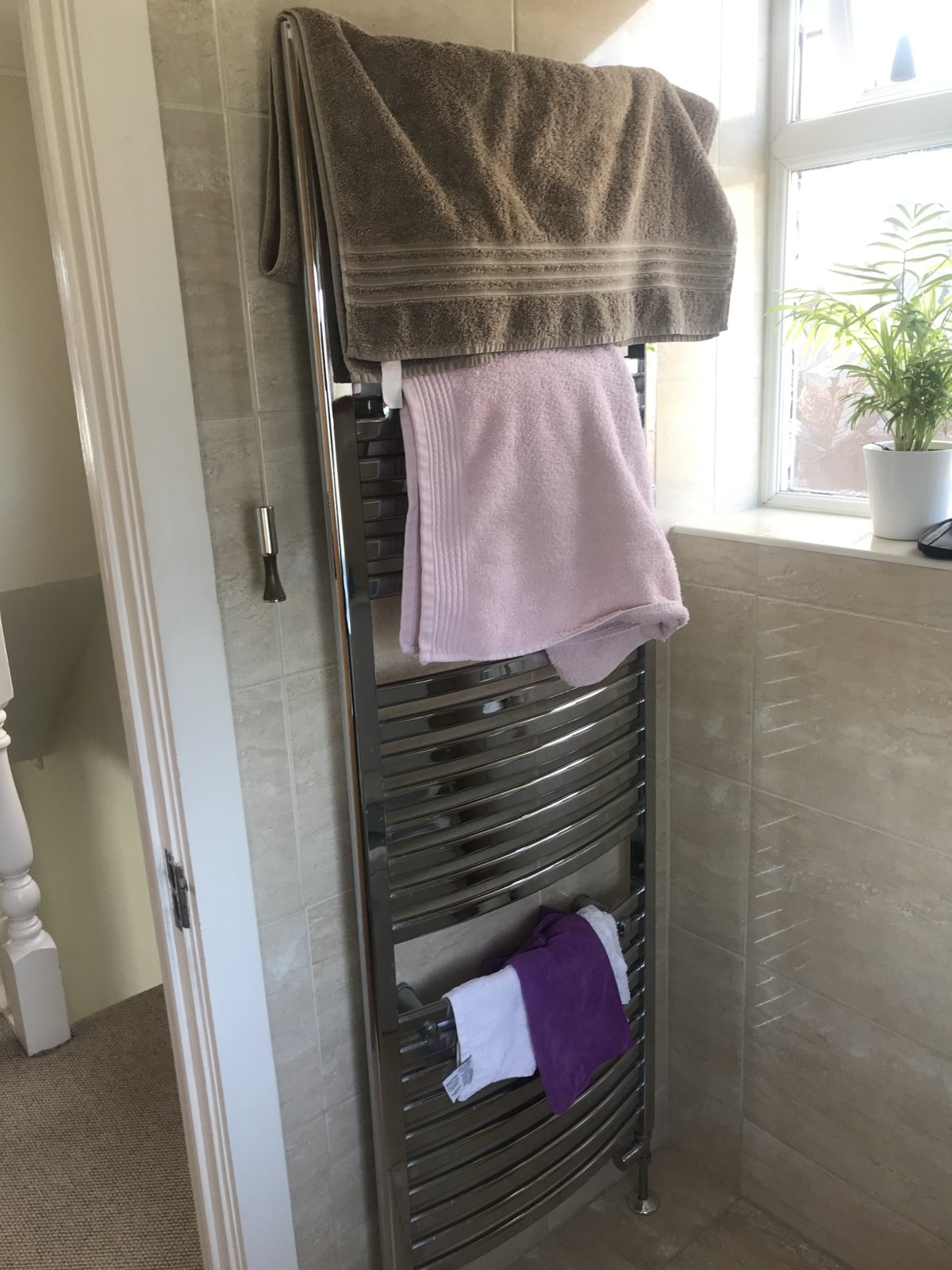

Depends on the type. Our one chucks out a fair bit of heat.
Mind you, this is how it normally looks. :LOL:
