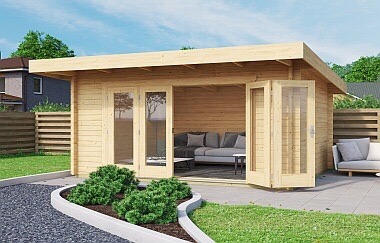

Thank you for adding me, you guys sure do know your stuff.
I am taking delivery of a 3x4m 44ml log cabin, we want to insulate the floor,walls and roof.
from reading many posts I am worried I might cause moisture to build up by applying the product wrongly.
Floors - Do we use Kingspan/Celotex so it touches the floor bit, leave a small gap between the Celotex and the base which in my case is slabbed. Will that give an airflow?
Roof - planning on having an EDPM rubber protection. So do we put a vapour barrier later in the top of the wood roof, then Celotex, then marine ply and then the EDPM? Walls? thanks

What make and model of log cabin are you buying? That'll help people steer you to the most appropriate guide or give tips on the detailing.
Hi,
We have ordered a Sussex 1 3x4m from Cabin Living
I think my husband is thinking directly onto the paving stones but as we want to insulate it would make sense to raise slightly to allow air flow, That way we could fit the Celotex firmly into the floor frame, what would you suggest?
