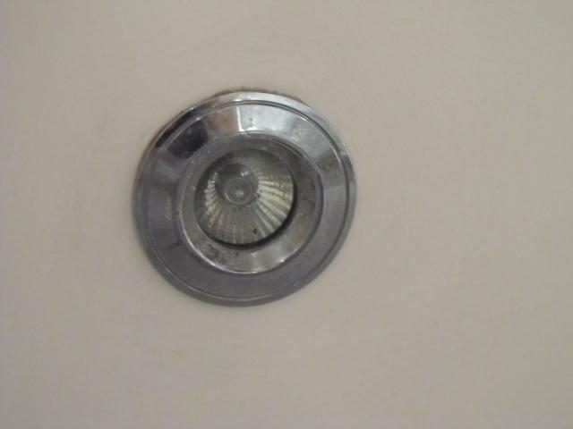

We have the above light in our bathroom and the bulb has gone. I gave up on OH changing it so tried to do it myself, but cannot fathom out how to change it as cant get to the bulb. OH said I was making mountain out of mole hill - until he looked at it and scratched his head a bit and agreed he couldn't work it out either. His mate popped round too and they both stood their scratching their heads! :) It seems to have a glass plate between the silver frame and the bulb and no matter how much we twist push or pull we cannot get to the bulb - any ideas?
Have attached picture

Not 100% sure but...
...I think you have to pull it down out of the ceiling and the bulb clips in to the fitting.
Mind the clips don't ruin the ceiling on the way out.
Pull the light down until you can get your fingers behind and press the clips in.

As above, ease it gently out of ceiling and it will be easier to fathom out
But be prepared for shower of plaster (and repair work to the ceiling) as they often go in a lot easier than they come out!
Thanks for the tips. We did try this, but couldn't pull it down far enough to get in to see/feel if there were any release clips. I feel I am going to have to do this one as OH may well bring down the whole ceiling!
