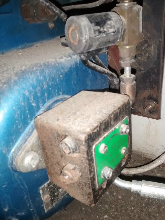

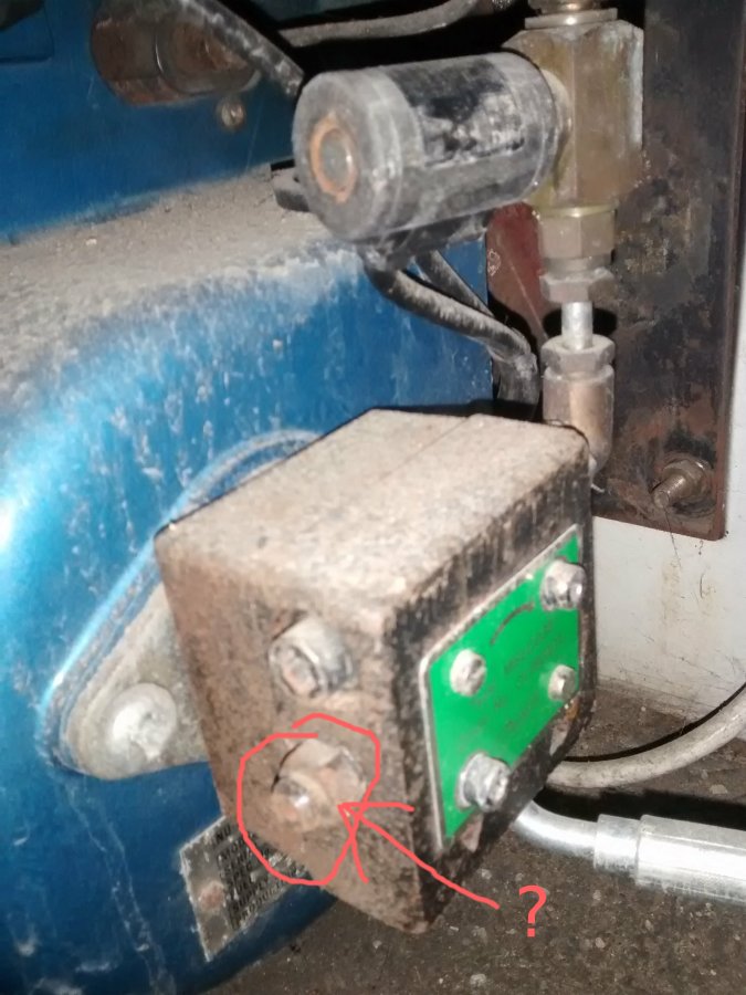

Hello. We have an airlock in the oil line of the burner here due to running out of oil. I've got an idea of the process of how to bleed the air out but just not 100% sure which is the right valve to open to bleed it. Pump is an old Danfoss MSLC032. I've attached a photo of the actual pump though it's not the best quality as it's very dark where the boiler is. I can take more pics if needed.
Thanks for any help you can give.

Hell that's a museum piece! Dont touch anything on the face where the plate is, but the lower of the fittings facing you is a bleed nipple, I'm pretty sure.
Crack it open and see if kero is there.....if not, try to start the burner with the nipple just cracked open - kitchen roll standing by!
Is your oil tank higher than the burner?

Just to be clear, we're talking about the fitting I've circled here? Is there any risk in getting it wrong? e.g. if that's not the right fitting to crack open?
That's the one.....all screws will be tight apart from one on the front panel which can adjust the oil pressure.
However, just in case I'm talking out of my backside - a frequent occurrence - put a spanner on and turn anticlockwise.....you can always return it to the set position afterwards.
Normally I would open a joint from a flexible pipe leading into the oil pump and bleed from there first - this usually gets things rolling.
Hope it goes well..... -4 here today!
John :)

Just want to say we got it going by bleeding from the fitting indicated, so thanks again for the help! Bit of a squealing noise coming from it but burner is going and producing heat.
