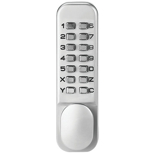

One of my rooms has this push button lock
Tried to open the door and it wont open.
When the combination is pressed, the pins do not spring back. The pins have no feel/spring.
Does anyone have any suggestions on things to try and how to get the door open.

Might someone have pressed all the buttons in? Press C to cancel all the latched buttons, and start again with the correct unlock code.
I have similar look for my back gate. If someone has used the wrong code, the buttons cannot be pressed until the cancel button has been hit.
Yes, I have pressed the C button several times, however the pins in the latched buttons do not reset. It is as if the spring within the mechanism has shifted and they have no feel.
I am hoping that there is a solution, because I want to avoid going down the grinder route.
It feels like the C button is not engaging the spring underneath to free the other pins
So when you press the C buttons, there is no resistance when there should be.
Got the door open.
For anyone with a similar issue, my advice would be to strike the top of the lock and the buttons with a hammer/ rubber malet etc
This frees the pins underneath.
Also, my advice would be to avoid mechanical pin locks like this.
Thanks for the suggestions guys.
Some additional advice, make sure you maintain your mechanical locks and lubricate them properly.
Those combination locks have worked for years without problem but when they go dry they can be problematic.
The above video is great advise for opening them, glad the whack with a hammer method also worked.
