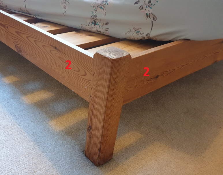

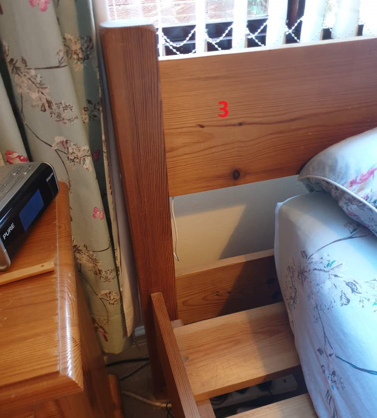

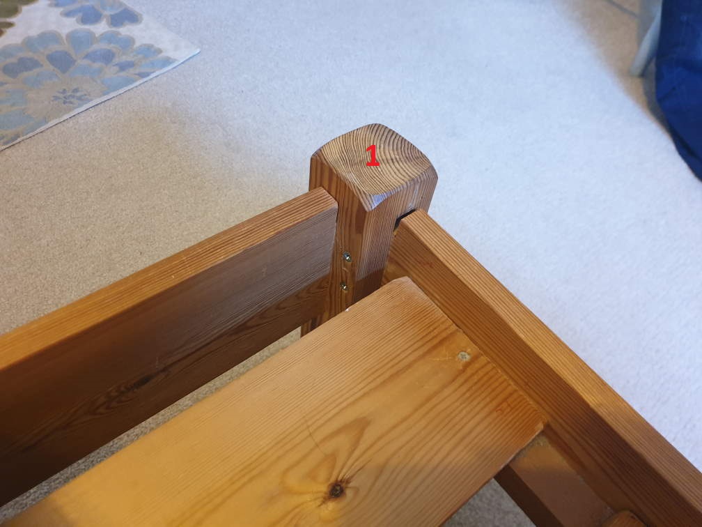

I’ve decided to build my own bed. I’ve slept in the same one for maybe 40 years, but now I need it to be a bit higher – I’m retired, bored, so have decided to try and replicate this one exactly, but maybe 6” higher. I’m pretty handy, but with experience of carpentry limited to putting shelves up etc, so I have two problems:
1. Does the wood used to build the existing bed appear to be of standard dimensions? It’s as follows:
1. 2¾” square
2. 5½” x ¾”
3. 8½” x ¾”
(Sorry to those who prefer Metric :eek: )
2. The cross-members at the head and foot of the bed are set into the legs, permanently (whereas the long side-pieces push in, then are secured with long screws). Do I need to buy something like a router to make the slots in the legs, or can I mark the shape out, drill lots of holes, then try and make it square (actually rectangular) with a chisel? And I assume the cross-members are glued in, as I can’t see any screws – what kind of glue is needed please?

If you simply want it higher you can add to the legs.
If you want to copy take it apart and make each component to match , cut legs longer . The joints can be avoided by using heavy duty angle brackets , so all you need are a saw and screwdriver to assemble .
with the cost of timber at the moment, it may be worth getting an idea of how much its going to cost to re-make. rather than just modify the legs, even possible buying ready made or flat packed from places like IKEA
Why not just add some legs on to the one you have? And then go and make something more interesting. :)
Well... two reasons, I suppose: (1) how would I remove the legs, as they appear to be glued in place? (2) the new wood would be a very different colour, wouldn't it :confused:

You can add to the legs not remove, like extending a newel post . Very easy to dye to match existing .

Scratch building seems an awful lot of trouble to go to, unless you have all the tools necessary, the skills and a cheap source the the materials - when compared to the cost of the ready made items. If you must, then I would be looking to modify what you have and there are a few potential ways which spring to mind...
1. Drill up through the centre of items 1 (Forsener bit), to accept a section of thick walled steel gas pipe - around 4" deep into 1, then add a castor on the end, or similar. The drilling would have to be perfectly straight.
2. Replace legs 1 with new ones of the length you want. The glued joints can probably taken apart with a bit of 'persuasion', then reassembled after.
3. You could make up some spacer blocks from 5x5", drilling and chiselling a tight socket for 1 to drop into.
4. Buy a pile of cheap hardback books from a charity shop and split the pile into four equal piles.
all standard wood yard/timber merchant sizes [preworked size]
Thanks, that’s what I wanted to know.
