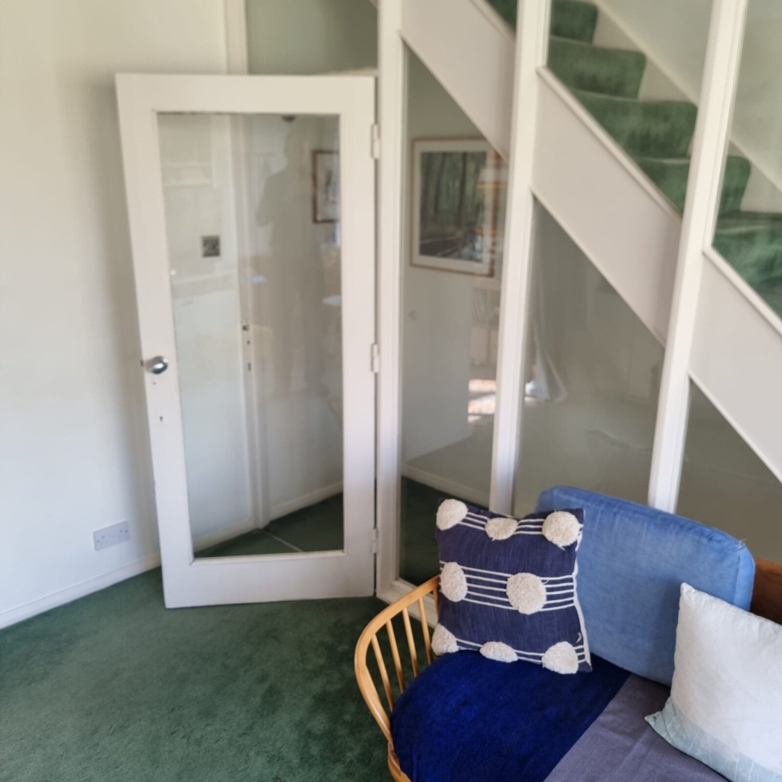

We've been told by building control that
"The door as well as glazed partition separating the 1st floor room from the ground to first floor staircase will need to be upgraded/replaced to 30 min fire resisting construction."
This is the door in question and the area that needs to be upgraded is the area below.
We can't get rid of the original feature here, and will need to put something behind the glass.
I'd really rather prefer a plaster board option, as replacing the glass will be cost probative. But then we'll have a thicker doorway that we will have to deal with!
Does anyone have any idea of what to do?
So many thanks for any ideas!

We've had a kitchen and a sprinkler system put in on the ground floor. This is the top of the stairs on the first floor coming up from the kitchen. BC doesn't care that there is a sprinkler system!

I'm not asking for advice on getting building control to change their minds. They aren't going to, we've tried.
They have said that we have to put in a fire partition and a fire door here. The question isn't do I need to. I need to.
HOW would you do this? If we put a partition wall on the stairs side can this be attached to the floor and wall? Would that provide a fire partition, does the wall and door need to be contiguous or can we put the new fire door in the existing door frame?

Leave the glass where it is and cover the existing frame with fireproof plasterboard on both sides.
Change door for a fire door.
Of course, as BC officers make up their own rules, ask them if this would satisfy them.
