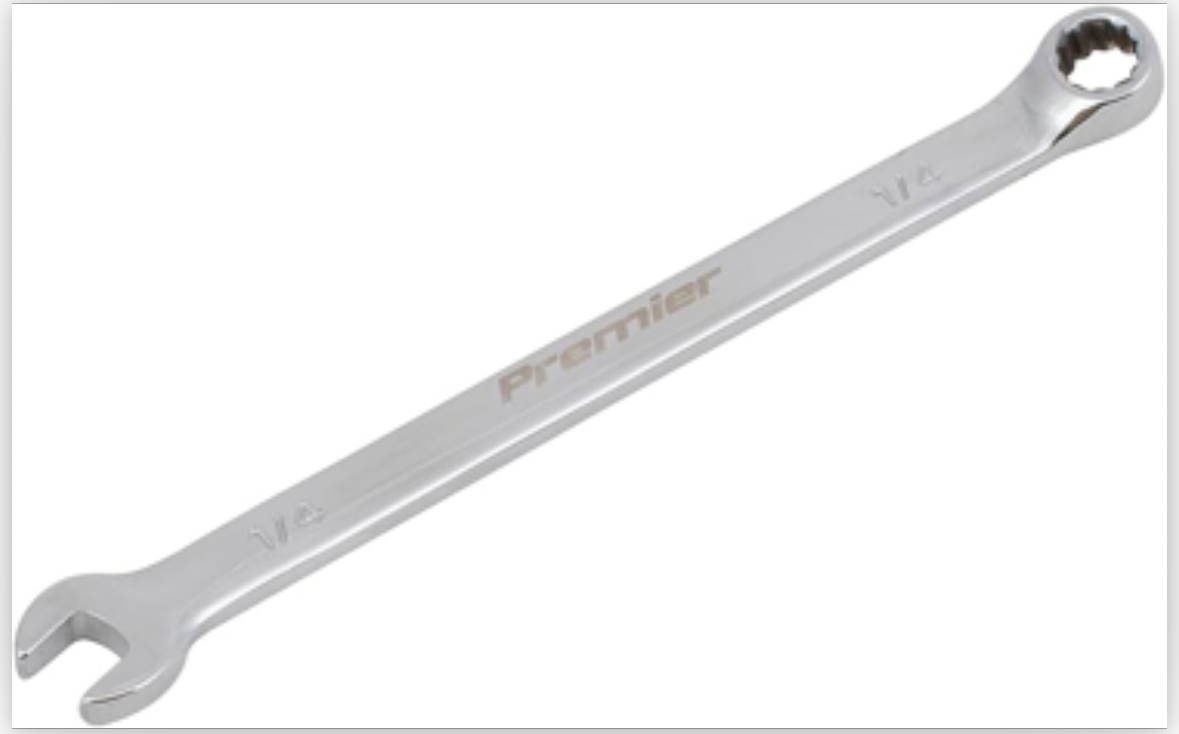

I need to screw my number plate in.
I have a really small space. Impossible to get any screwdriver in - the space must be 15mm.
I purchased a ratchet wrench, that is almost the right size - but just 2mm too much. Or maybe I need more space to allow for the screw head.
So... I thought... if I can cut a standard screw bit in half, that would be perfect.
I've only got a jigsaw saw. Cutting it in half would be a dangerous job! I need to have held by a clamp of some sort.
I've got a Work Bench Saw Horse Clamp Table (had to look up the name!)
I could probably use that very carefully.
Any other ideas?

I bought this item to try and screw in a screw:
It's neeeearly just right. But I still need a few mm more.

Obtain a 1/4 inch combination spanner:
Cut your screw bit down and place it in the screw. Hold it in place with a slim screwdriver then use the open end of the spanner to turn the bit 1/6 to 1/3 turn at a time
Alternatively glue the bit into the ring end and turn 90 degrees at a time by removing and reapplying the bit to the screw
