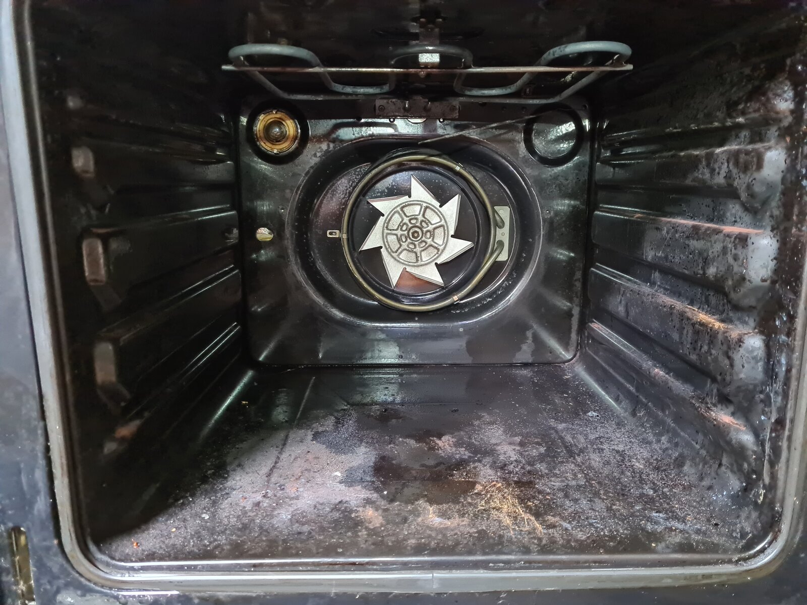

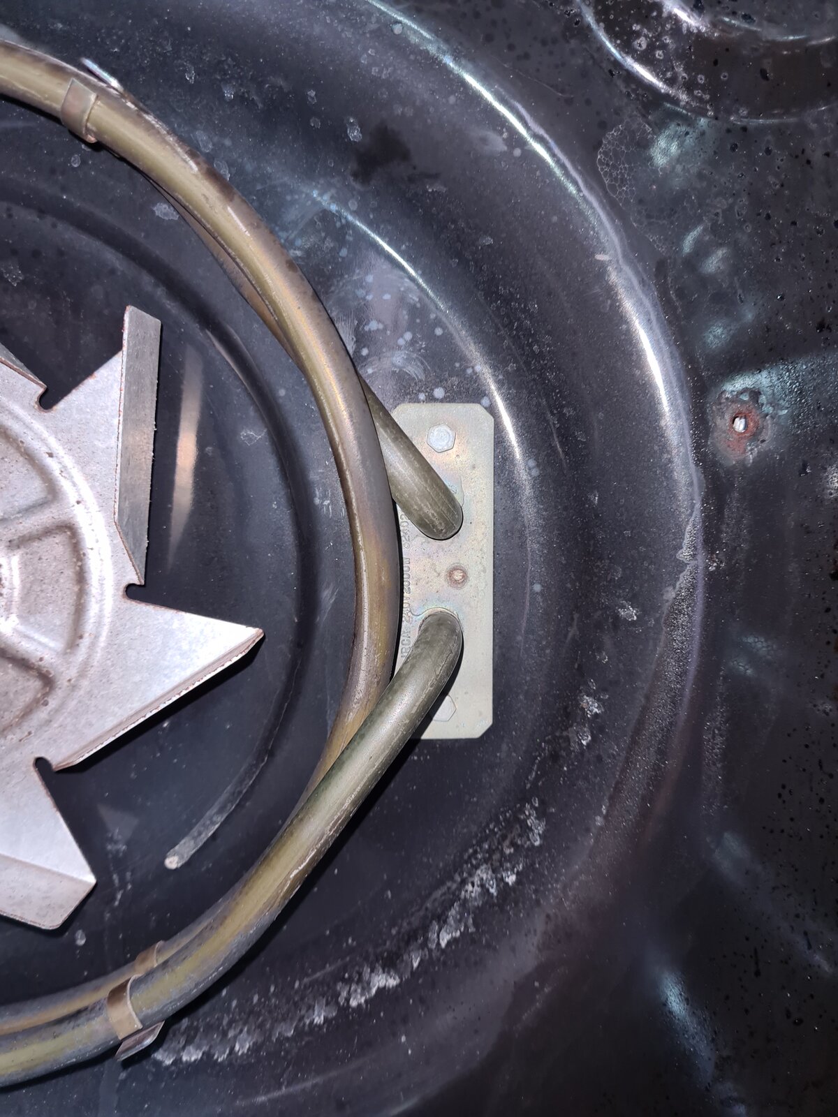

Hey folk,
Heat element is gone and trying to remove it but it seems to be held on with bolts on the otherside.
Backplate feels solidly helded. What am I missing?
Cheers

it looks like a typical element in a fan oven. The backplate is part of the element (not removable from it) and possibly has studs or bolts protruding through the oven wall and retained by screwing on the reverse side. on reassembly, use copper grease on the studs as it continues to lubricate even after heat. looking at your pic I think I can see two hexagonal heads of bolts that can be undone with a small socket spanner and T-bar. there may be nuts on the other side.
or the backplate may hold the plug-in support, and can be pulled out, you will find a socket behind it.
if you look at the new element its attachment should be clear.
have you got the new element?
for example this one
apears to have holes for fixing screws, but some do not, so it is essential to get the right one for your model, and possibly serial number.

I haven't picked up a new element as can not find the seriel number of the oven anywhere around the door, kick plate has also been glued to the base of it so probably hidden there.
Looking to get the element removed to ensure I get the correct one. Will grab a spanner and see if I can get it shifted.
You need to pull the oven out and check on the hidden back for the details. It will need to be pulled to anyway, to replace the element.
