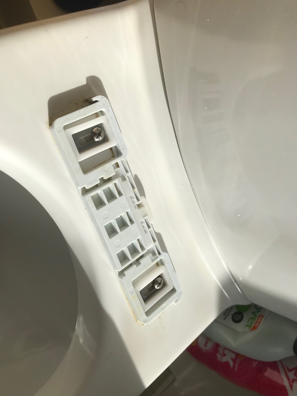

Hi,
I m trying to change the toilet seat. I dont think its like a normal toilet seat which has 2 screw bits either side which you have to undo. I think its a slimline toilet (ie smaller than a standard toilet)
This is the view looking down onto the back of the seat (with the lid closed)
And this is the front
Has anyone changed a toilet seat on one of these before? Thanks
I know - its absolutely disgusting. (its not my toilet!!!)
You can see a clip thing at the back which looks like it should loosen the seat, but it doesnt.
The clip thing on the back sticking out should slide one way or the other then the full toilet seat will slide off clip is on pic two then you will be left.with the bracket which screws on the wc

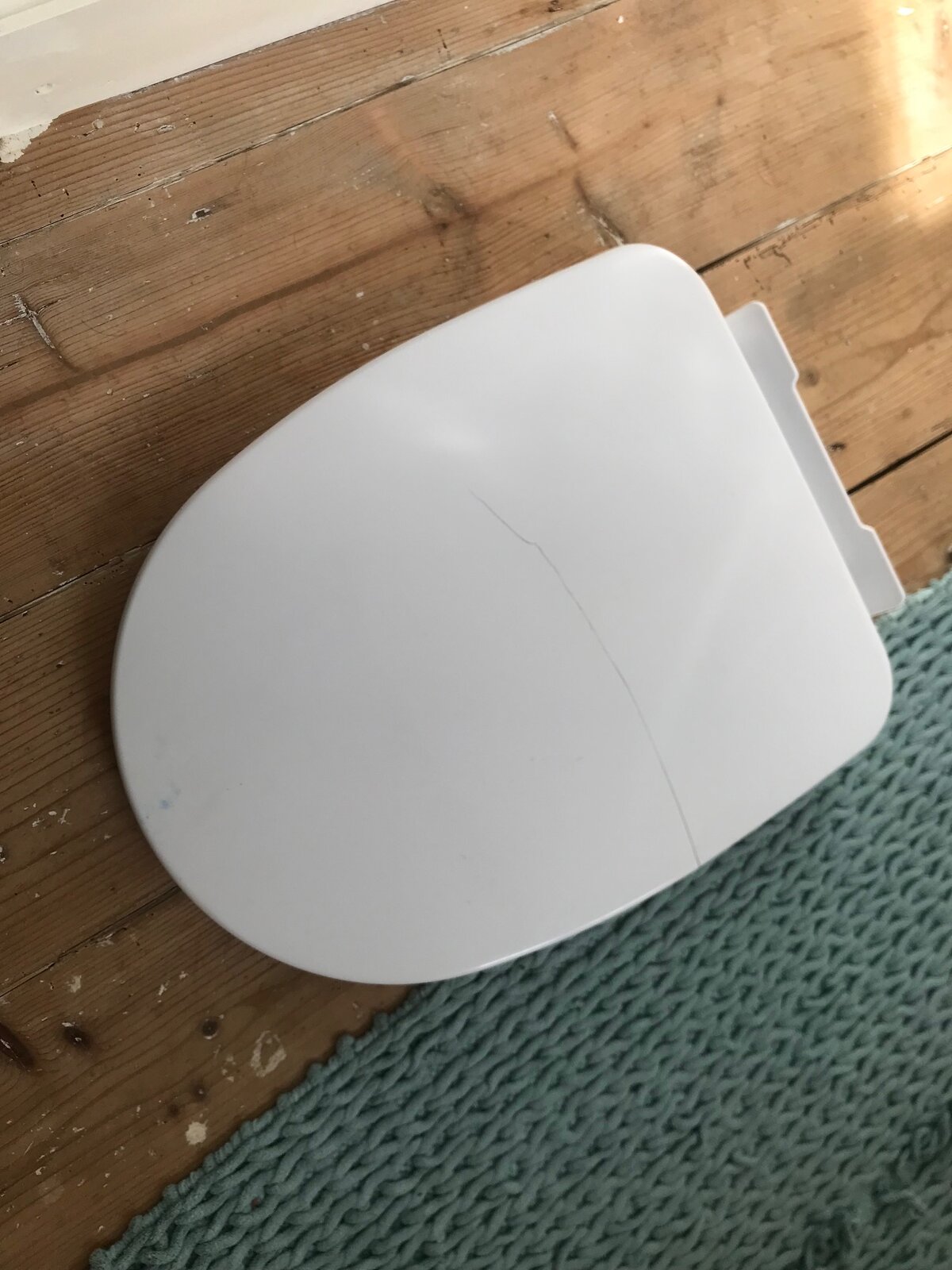

Anyway, I got bored being laid in bed so thought Id take another stab at this damn toilet seat. It slid off easily just like you said (easy when you know how).
Im looking for a replacement lid rather than both the lid AND the seat. I suppose they arent sold separately. I cant find any toilet lids with this fixing? Is it classed as a 'top fixing' seat or something?

Ive just established that the seat is a "quick release" D shaped lid. Googling this has given me many options thanks.
This type of lid is good - its super quick to remove the whole lid making it easy to clean the toilet. Ingenious!
