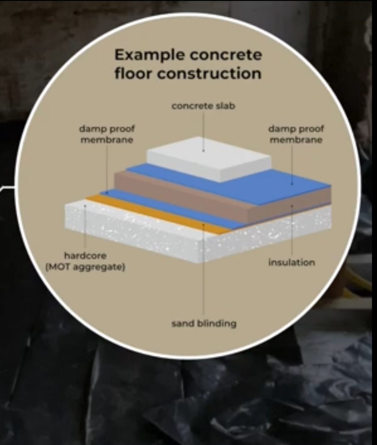

Also would anyone know how much room I will need (so I can work out how much ceiling height I'll have - if it'll mean I will be left with shorter ceiling height then I won't bother as it's not got great headroom to begin with). I found this but it gives no measurements:
If that's between 5-10cm hardcore, 10 insulation and 10 concrete, should I allow for 30cm?
At least, plus screed and finished floor. Theres a lot of materials to be taken out and brought in, plus the structural implications of tne existing footings and removal of the internal wall, and potential issues around damp proofing basements. Additional costs if a listed building.

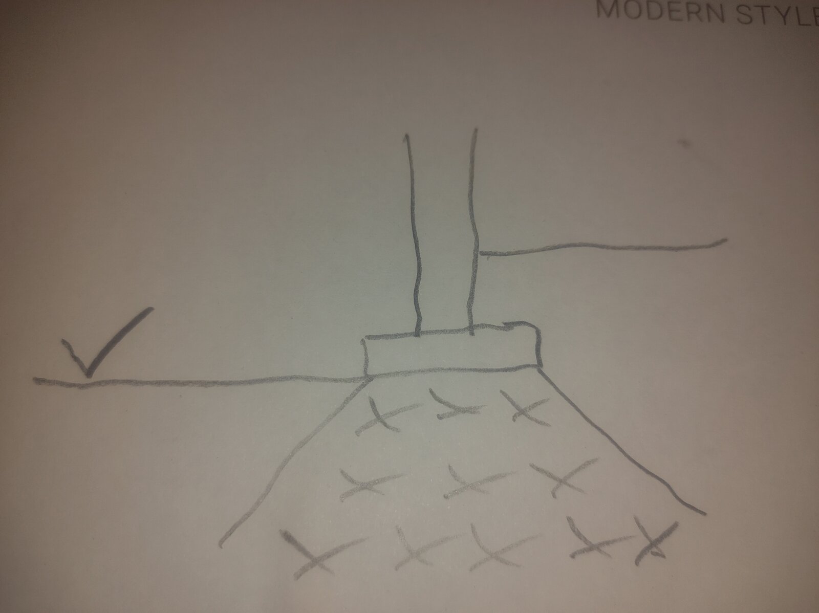

The only way to check footings is to dig a hole next to them and look.
A floor slab for a basement does not necessarily need to be the same thickness as a floor slab at ground level. It depends on the ground type and condition.
You do need to be careening careful when excavating adjacent to walls and their foundations, and any new floor slab may need additional design consideration for that alone.

My picture shows the basic principle of what you can do near foundations without engineering input.
You're unlikely to find a concrete strip under yours, maybe a wider "plinth" arrangement or just built straight off the ground. But only one way to find out!
And old stone house is pretty likely to have no foundation at all
I can confirm that. My old cottage (( C17 cottage, formerly a pair. Limestone rubble and thatch, )) has no foundations, It ad built on compacted earth and over the first few years the weight of walls compressed the ground even more.
