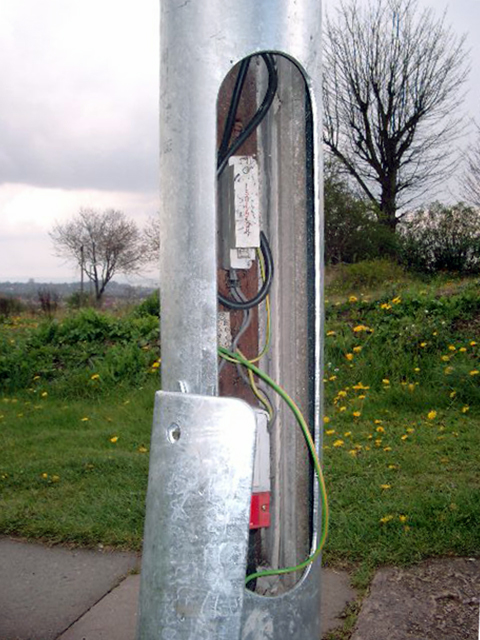

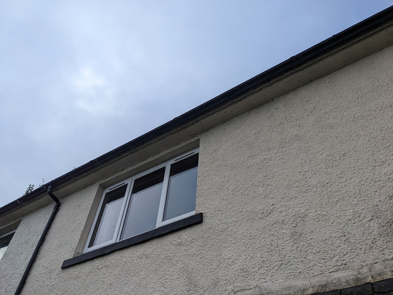

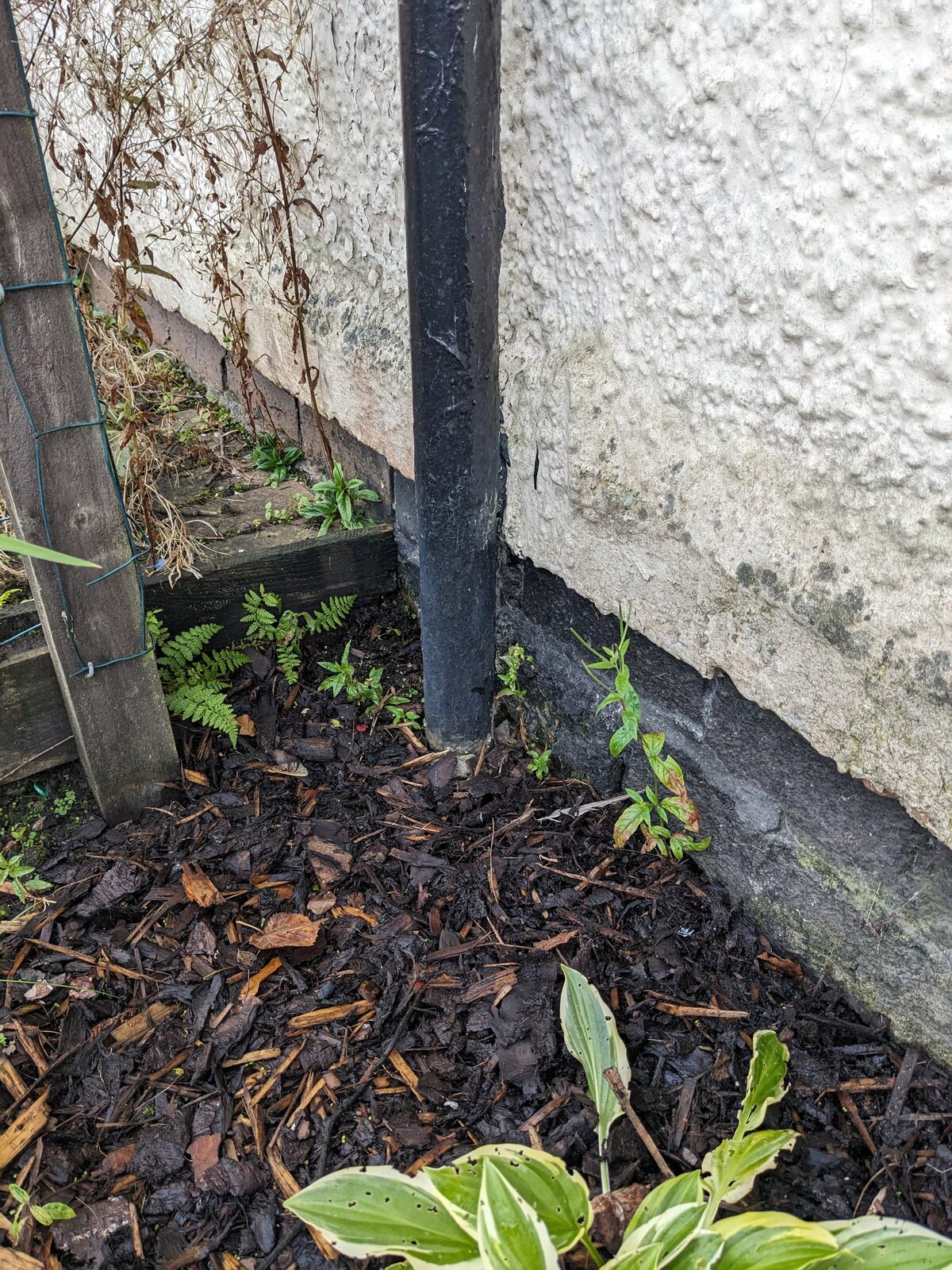

Thanks for the replies, some good thoughts. I've attached some pictures for reference. The picture of the lamp post (pic 3) is what I had visualised in terms of an access hole that I alluded to in the original post, although I need to think about the advantage of cutting a whole section out and replacing with couplers. As well as thinking about whether the whole thing might be silted up and thus all of this is futile.
We get a lot of moss on the roof and in the gutter. You can see the neighbour has plants growing out of his (pic 2), whilst ours is clear along to the drainpipe (well, relatively, it could do with another clear out which we do from the loft room using a long pole).
And pic 1 is the downpipe going into a concrete base. No manhole nearby to look in.

Is it cast iron? It looks like it's been embedded in the render too so that means cutting it is out without screwing up the wall and making a hole is easier said than done. Time for a ladder I'd say. Or get a gutter clearing bloke in to have a look, a lot of window cleaners also do gutters, they'd probably have a look if you get them to do your windows.
That dogleg, from the gutter, back to the wall - it looks a prime location for blocking by moss, and would be my first check. You might be able to tap the fall pipe at the ground, gently with a hammer - to detect whether it is full or empty of water/debris.
