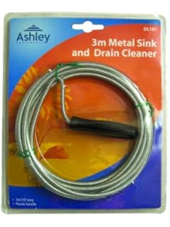

Get ya self one of these and safe ££s on plumbers fees..
Jedi, I can't use that (I already have one) as I cannot access the waste pipe. I don't think it's possible via the waste.
