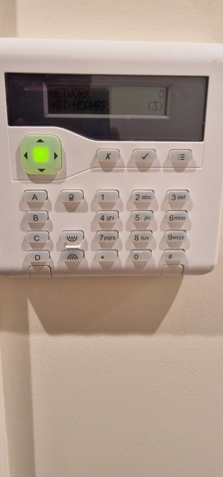

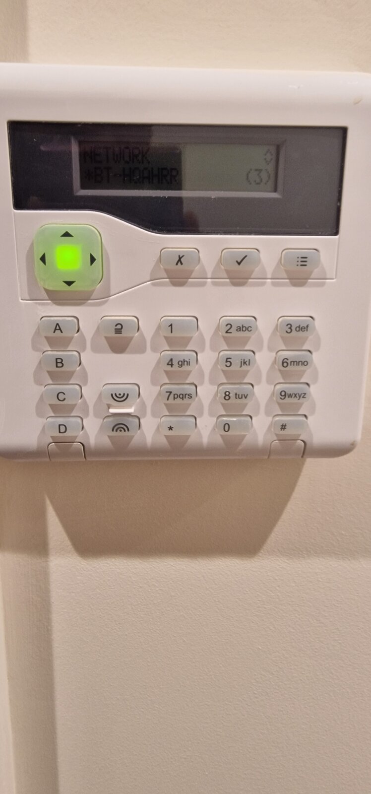

I have a new router and need to configure the WIFI password. I have searched hard and cannot find how to do it.
1. How do I scan for the new router.
2. How do I toggle between between upper and lower case.
Thanks in advance.

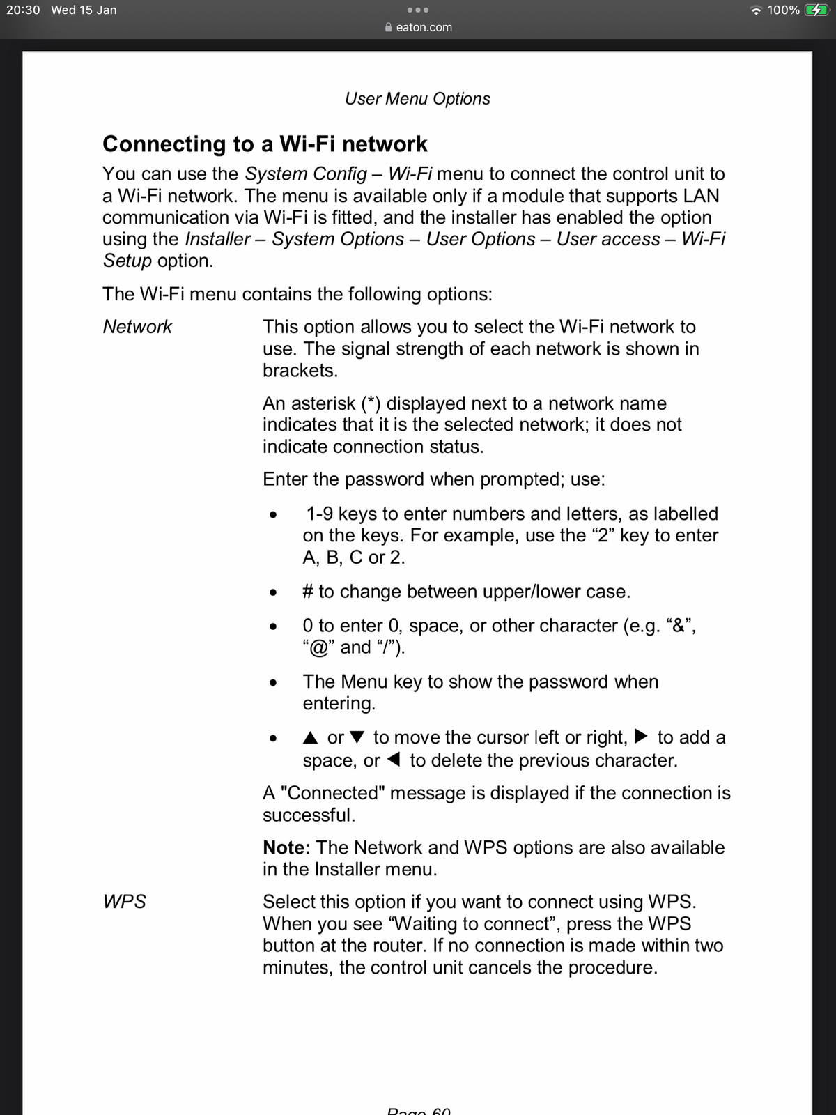

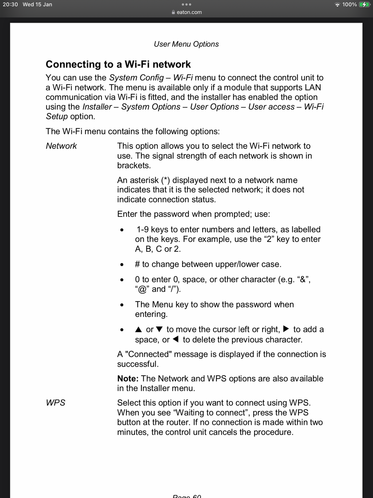

Try google ….i would use the WPS option ….not a ion installer, don’t think they are that popular…
