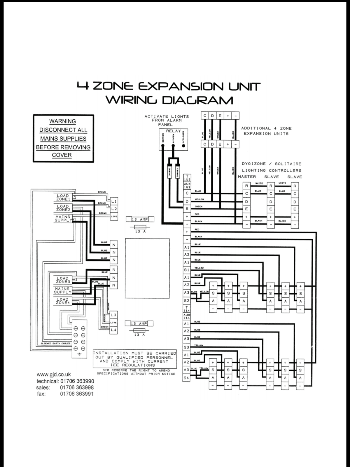

Can anyone please advise how I connect a texecom alarm to a GJD 040 expansion module to bring exterior lights on when the alarm sounds.
I am hoping to use a texecom veritas r8+
Or a texecom premier elite 24.
Thanks to anyone in advance.
You will need a relay .... and a couple of diodes ....
You will need a 12 volt relay and 2 IN4002 diodes
You can connect to bell trigger or program an output.
Connect as per diagram

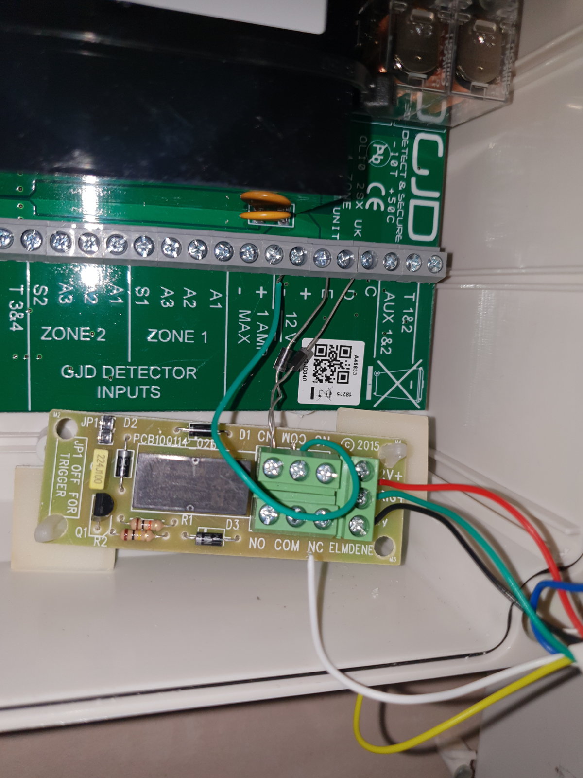

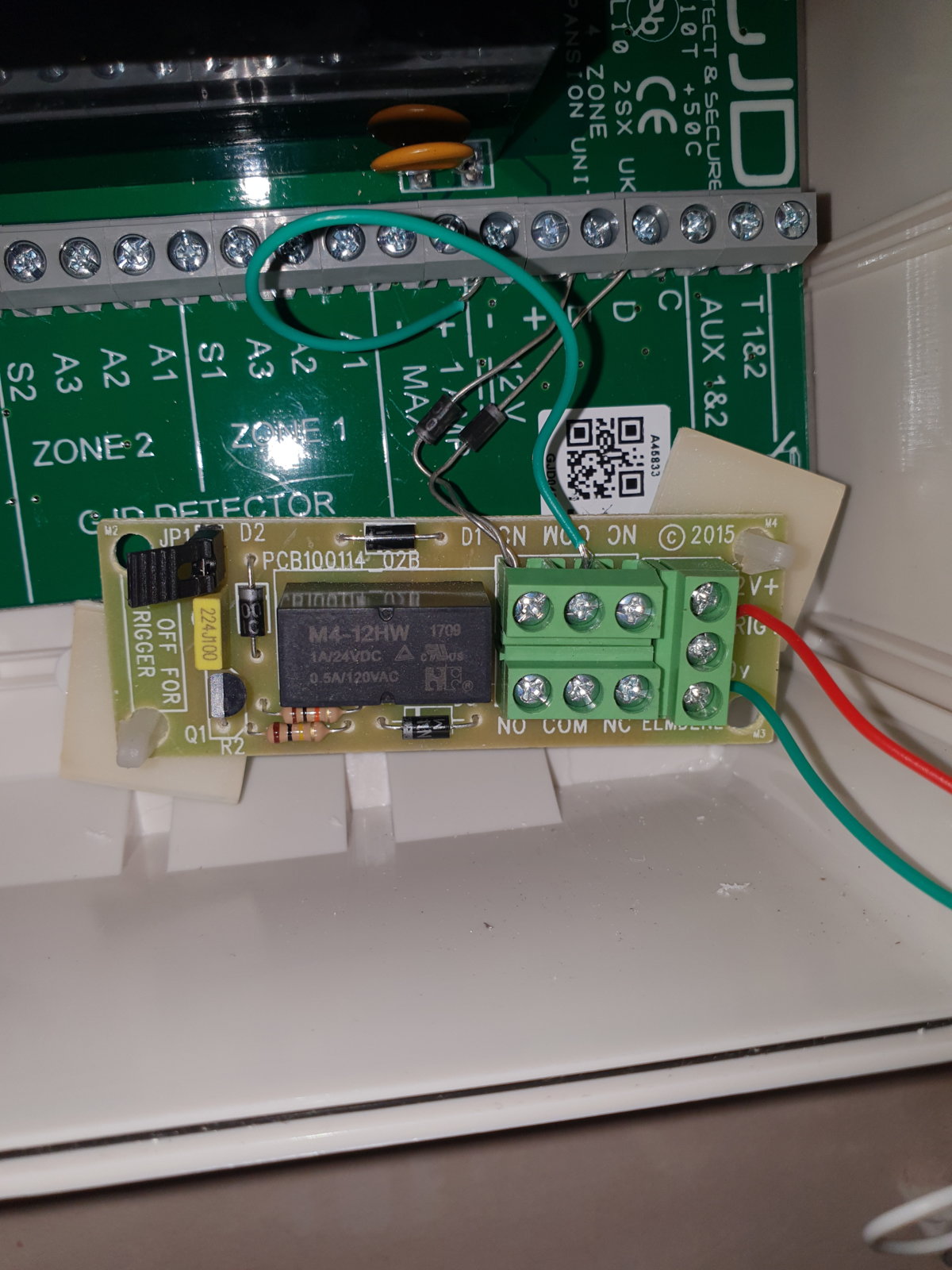

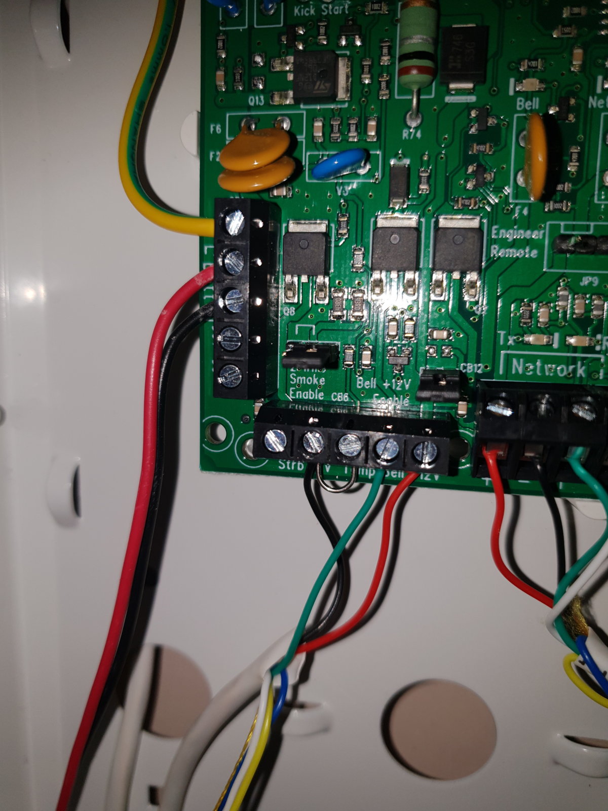

Can anyone please advise how this relay needs to be connected to the alarm panel and lighting controll relay.
I'm wanting to connect it to the bell output of the alarm panel.
