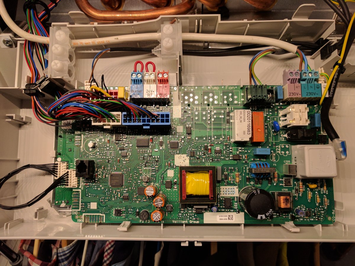

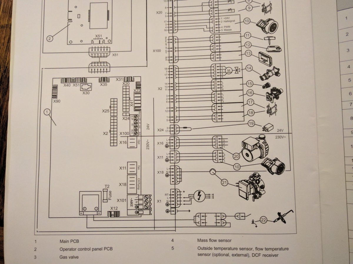

I have a Vaillant ecoTec 832 (combi boiler) with a vaillant RF 350 thermostat and I am looking into replacing it with a smart thermostat either the nest or the hive.
circuit board: https://goo.gl/photos/ZsiE4uNBobobrFnp8
schematic: https://goo.gl/photos/N6vT8yuu9Y5wDRoj8
I am guessing I will have to remove the RF 350 panel from the boiler for this to work, right? I did not keep the original panel. Hopefully this won't be a problem.
Can anyone confirm that this is correct?
I should first remove the loop on 24v=RT (24 v dc room thermostat).
For nest:
- the boiler RT / 230V AC room thermostat socket (at X1) should be connected to the nest heat link socket 2
- the boiler L socket (at X1) should be connected to the nest heat link socket 3
For hive:
- the boiler RT / 230V AC room thermostat socket (at X1) should be connected to the Hive Heating On
- the boiler L socket (at X1) should be connected to the Hive Common (or hot water off)
