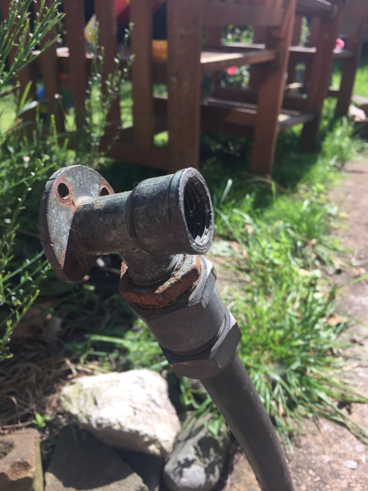

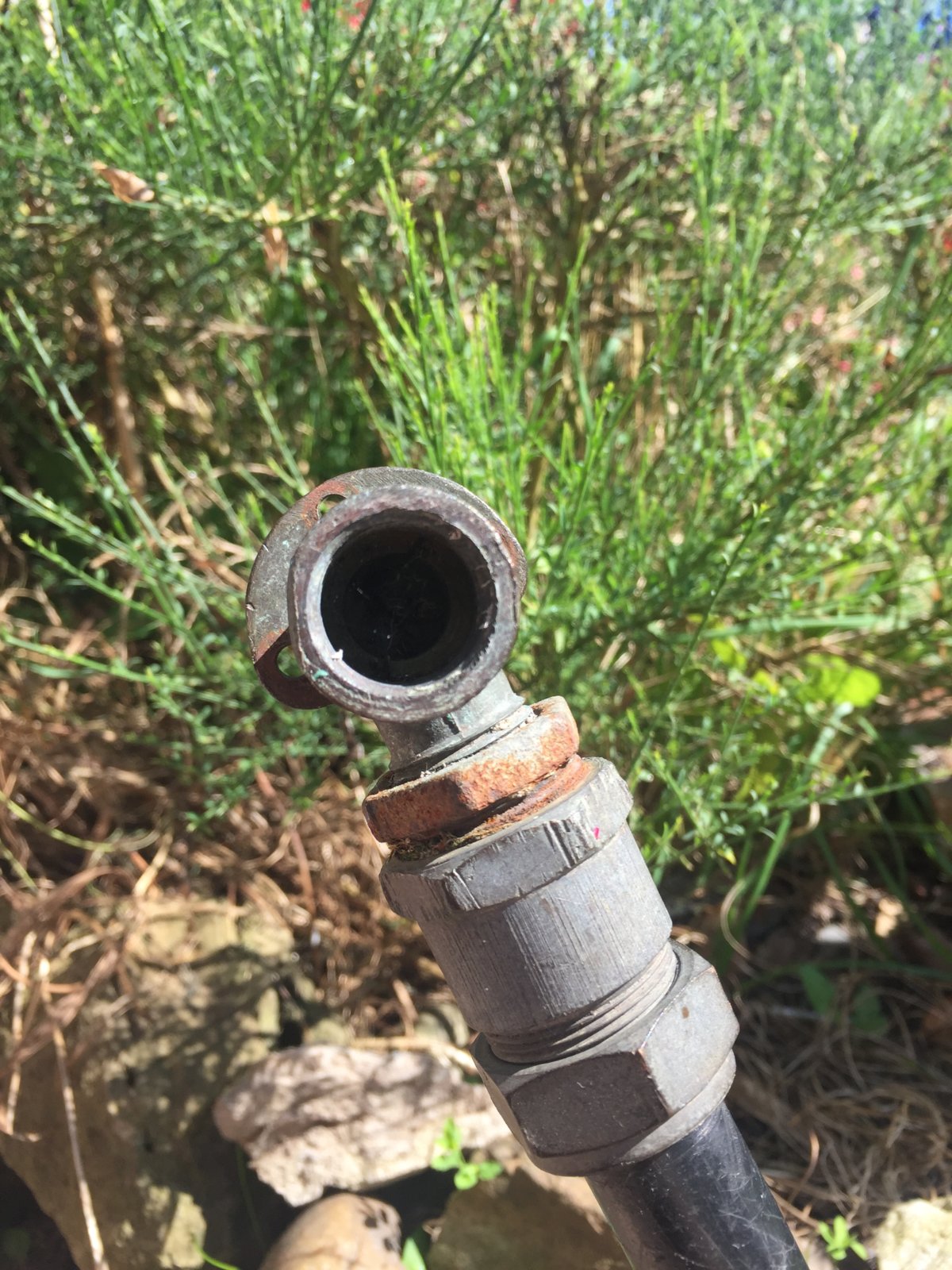

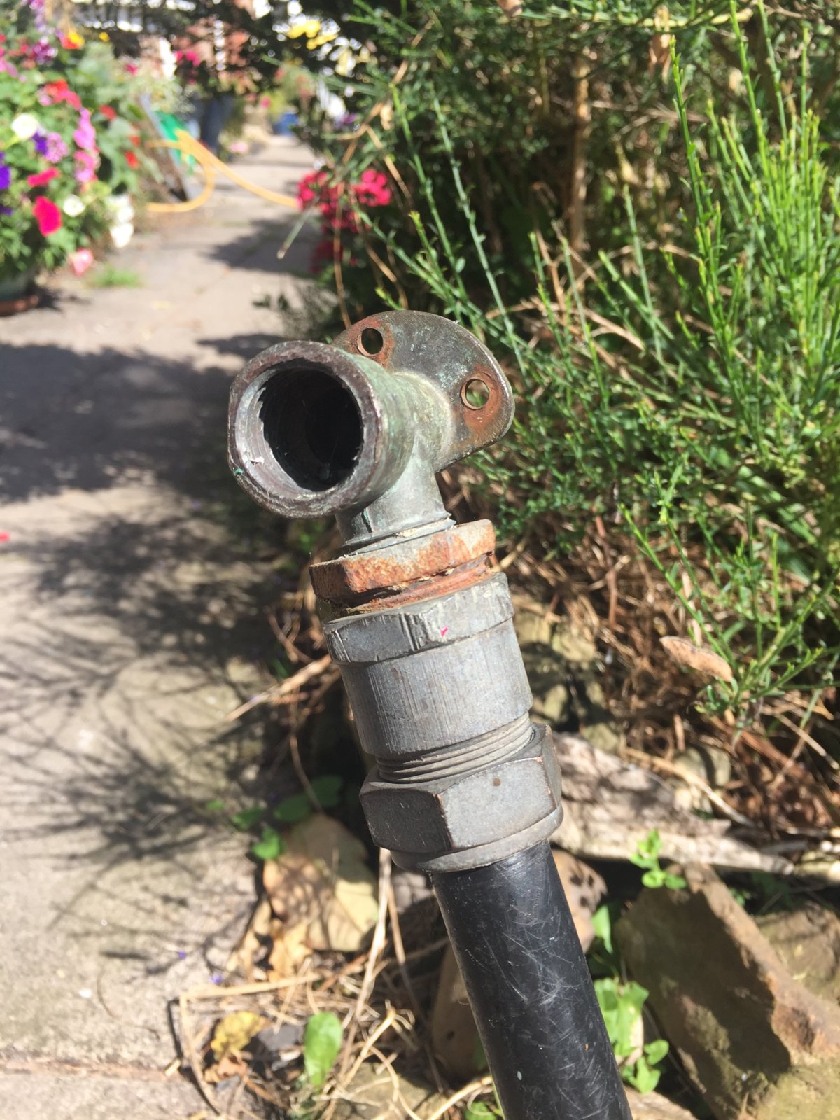

I don't know if this is the right place but seeing as it's near the garden I thought it best to post here.
Anyway, there is a pipe coming out of ground outside my house and I was told by one of the neighbours that the previous owners used to connect a garden hose to this and water the garden.
Could anyone tell from the uploaded images how I would attach a tap or whatever I need to get running water? There is no other outside tap in the property so I'm hoping this will be.

Depends what is at the other end;)
The fitting its self is a standard bsp screwed thread, usually 1/2 inch so a normal garden tap will fit as a rough guide if your finger fits in it its 1/2" if your thumb fits it is 3/4" (as long as you have British standard fingers) don't get it stuck or slice it on the thread or you may end up on "You've been framed" :LOL:
You need to trace the supply end and see if it is connected, it might well have been cut off after a frost caused a leak on the pipe.
