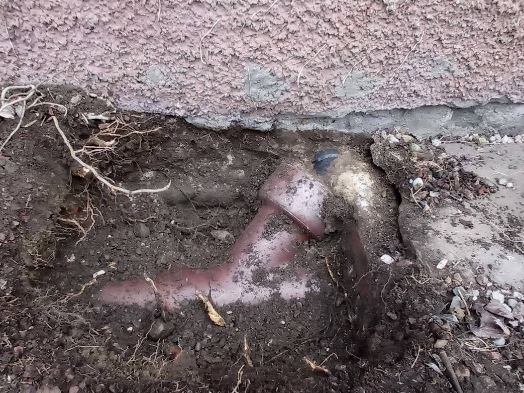

Crikey, that looks alike a bit of a mission to do anything with. Have we any pics of the inside of the property? there really isn't anything to couple to there, without removing the clay junction and replacing it, but that would entail breaking out the concrete to get to the pipe upstream of the junction.
Having said that, the junction looks like it's cracked to me, so may well need replacing regardless.
Upstream of the pipe is a buchan trap. We are thinking to dig that out and put a modern rodding point which will allow us to go into the wall further upstream (to the right in the picture) which would be much better for us, as it will give us a much better run to the new position for the toilet.
White line shows Y junction from previous picture.
