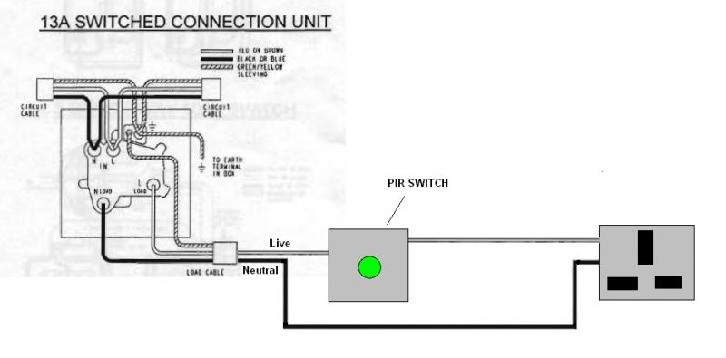

no, no, no. You need a fused connection unit in line to the PIR.
Beware, most PIRs have a minimum load. LEDs may not satisfy this. Why do you want energy saving switch supplying a product that, if it used any less electricity, would actually generate it? ;) Just put a switched FCU there.

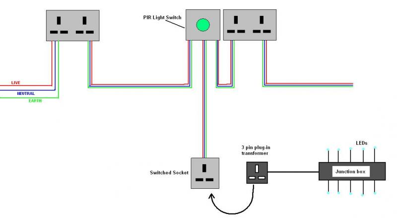

Thanks for the quick reply. I want a PIR switch, not to save energy, but so that if someone walks into the kitchen at night the LED lights automatically turn on, so the main lights don't have to be turned on.
What do you mean by a fused connection unit in line to the PIR?
Can it be looped with the power sockets?
I am far from an electrician so my knowledge is limited, but I'll have to explain it to my builder or show him a diagram how I want it.
The correct method is to put a fused connection unit with a 3A fuse in the position you have the PIR in the diagram, then a short cable from the FCU to the PIR, then a cable from the PIR to the socket.

Do I really need the fused connection unit?
YES! If you are insistant on supplying a PIR from the ring final circuit then you must have an FCU.
You'd be much better off supplying a socket from the lighting circuit though.
Have a 2 gang switch inside the door, one for the main ceiling lights and the other for your LEDs
