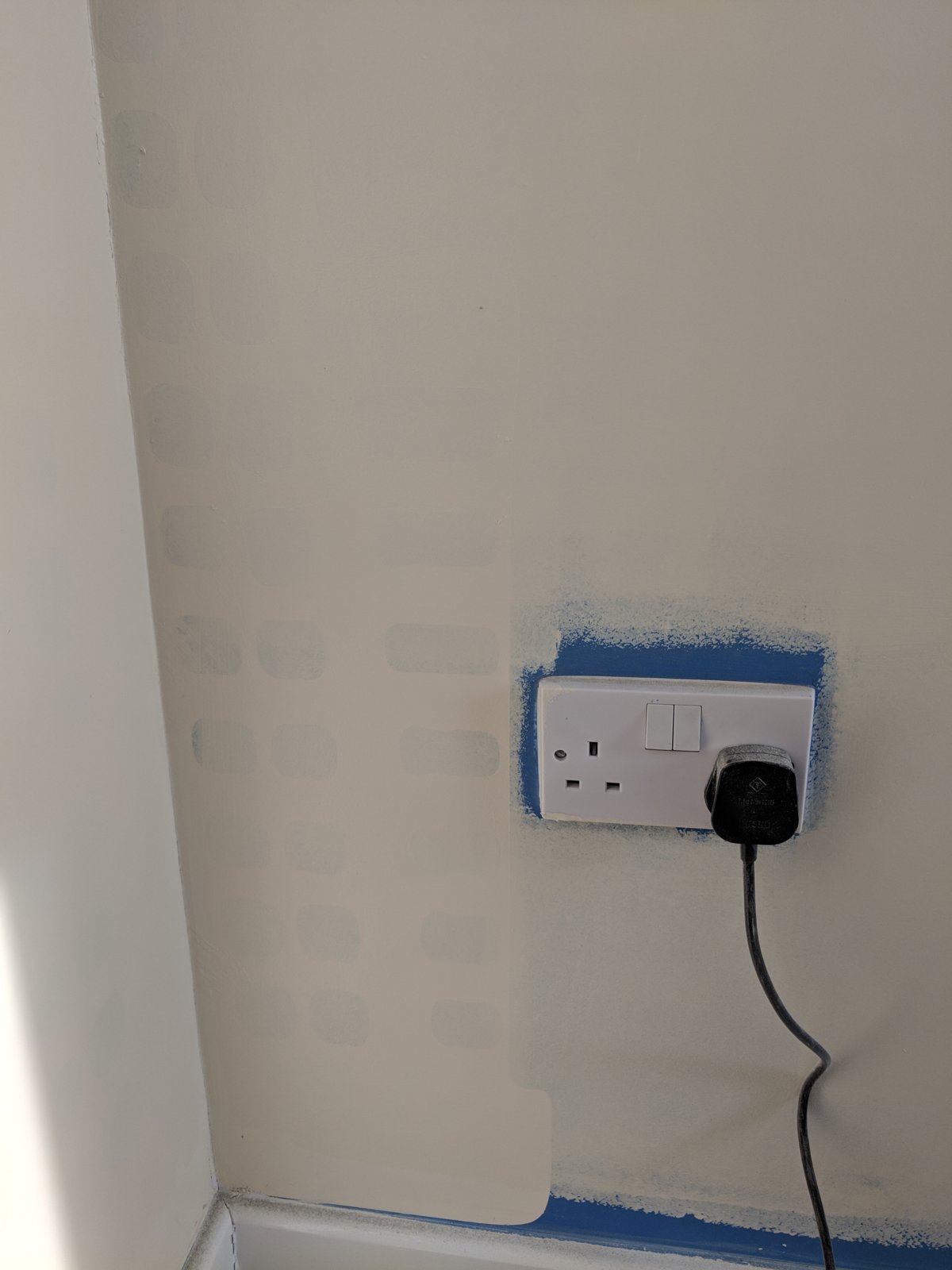

Hi after some advice is there an easy way to remove stenciled paint off our bedroom wall left by the previous people?
We thought we could just whack on a load of magnolia paint to cover the dark blue as a base coat but you can still see the lines from where they've stenciled buildings and superheroes onto the wall, especially in the light.
Is the only way sanding the entire wall? Or can we not just buy some thick white paint which will cover over the lines?
Friend has mentioned zinsser primer paint or even light surface filler ?

Very hard to see in the picture the problem, but a very good rub down would be the way to go, Zinserr paint isn't going to help cover the lines, they are ridges and will need sanding down to a flat surface.
Most paints are the same thickness so thats out, if you cant sand out the lines, paper the walls with heavy grade lining paper.
High opacity paint should work. But not if you have actual lumps of stencilled paint
I have sanded walls before and it's really messy and dust gets everywhere

Yes it has been a nightmare.
Managed to get most of it off using a hairdryer but I've been left with a faint line which I've sanded down hoping a few coats will cover it.
