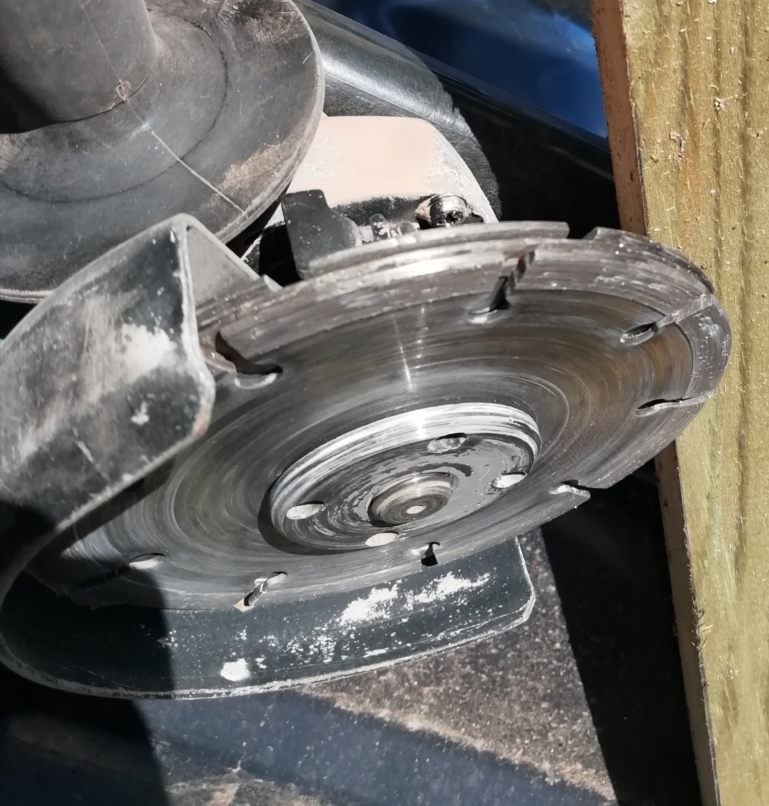

Apron flashing to polycarbonate roof lean to. Wall is rough cast render.
I set a shortish peice (mistake#1) of wood as a height guide onto ledger board and used a 5" diamond blade to cut a line. Worked not bad.
Then cut about 8mm off guide board and repeated to make hopefully a 10mm ish max slot to put lead and hall fixings into.
Instead I have a wandering mess from 8-20 mm.
Looks awful. Too big in places for hall clips. Lead is going to wander around to the line.
I can cut it again higher and and cover the bad chase using a wider piece of lead- was only giving a 3" drop so it's all for the best
Not usually so cack handed but it was really difficult.
Is there a tool /method I need?
Think hall clips need 8-16mm...
Thanks in advance.
