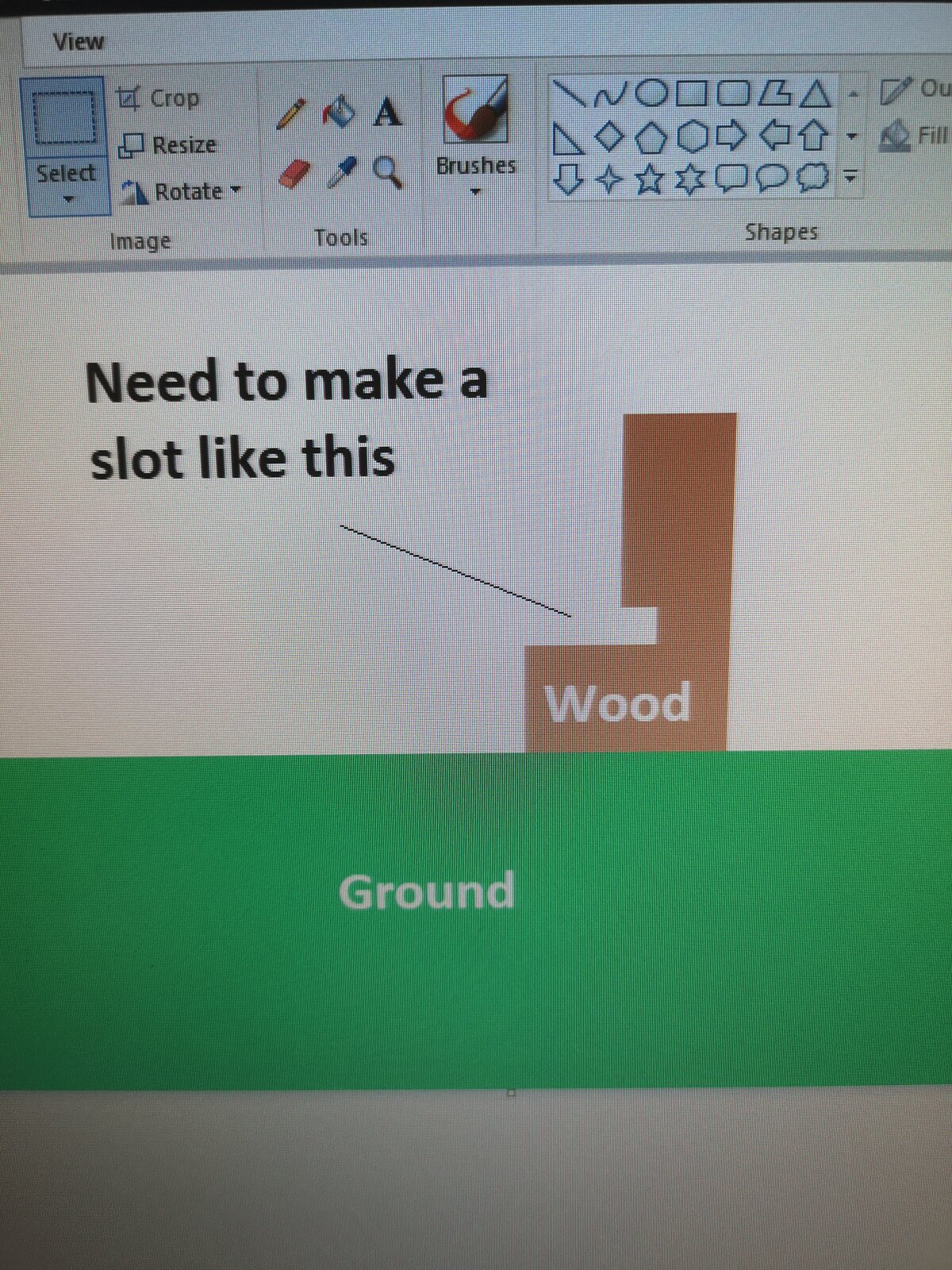

Hi guys.
I have a wooden border fixed to the ground that cant be moved or disassembled. The cross sectional view makes it look like an L shape (please see image attached).
I need to cut a slot at the bottom of one side of the wood right on the L. I cant get at it with my router as it is quite high (bits wont be long enough).
I have 24m of wood to cut this slot in with internal corners.
What would be the cleanest was to cut the slot? It needs to be around 1cm x 1cm.
I was thinking a door trimming saw before I saw the internal corners.
I suppose a special router bit isn't possible? Like a milling bit?

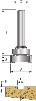

Trying to cut a 10 x 10mm slot in a single pass is the sort if job you can do with a 1/2in router and a top bearing slotting bit, like an intumescent bearing bit:
The problem is that the greatest depth of cut you can get on this type of cutter "E" (with an accessory guide bearing) is 7.5mm, although the height if the cut "B" can be 10mm. With an 82mm long shank that means your slot could be 50 to 55mm down from the top.
You might be able to use a router cutter extender to get you 100mm down off the top, but these extenders are really designed for use with the router fixed in a table and are generally regarded as too hazardous to use on a hand held router. In other words it is a dangerous combination
About the only thing I can think of would be an antique 3/8in shoulder plane, with the corners being dealt with by hand chisels. A multitool and strip of 10mm ply (as a guide to run the blade against) could replace the shoulder plane, but wouldn't give such neat results. Either way, very labourious
