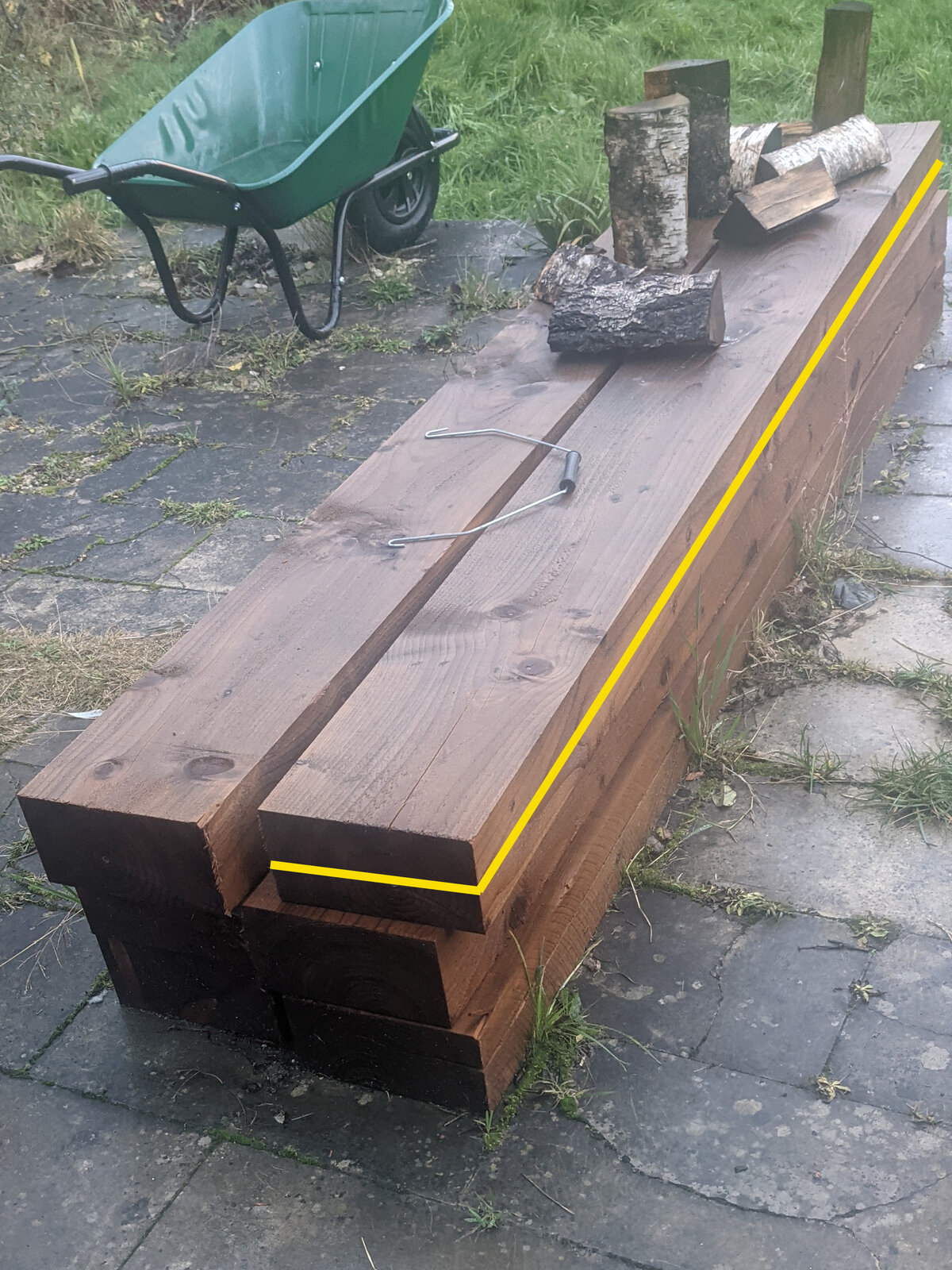

I have these 24cm x 12cm x 3.2m timber, that I want to cut lengthways via the short edge (as per yellow line in picture)
Problem - a standard circular saw isn't deep enough to cut through, even if I cut both sides.
Does anyone know of a decent jig I could use with a chainsaw? The cut needs to be straight, as I'm turning them into veg boxes.
Thanks!

As somebody in the trade, I can say deeping timber is difficult and there is no cheap solution
a chainsaw jig a sort of possible -there are some examples on youtube however you would be rip cutting which is not the conventional use for a chainsaw as chains are set up for cross cutting
