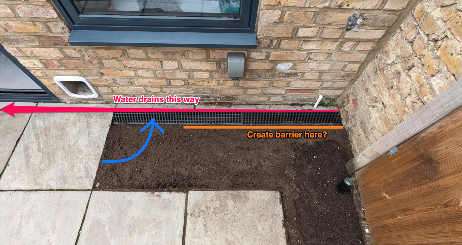

Builders recently removed some patio slabs from our garden. We plan to plant a small tree and some plants, so the slabs have been replaced with soil. The removed slabs used to hide a small drainage channel. They were in a rush to complete the job and simply placed two drain covers between the soil and the remaining slabs.

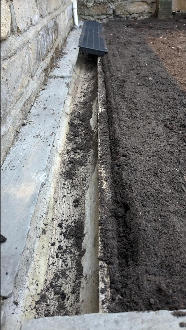

When it's rainy or windy, the soil falls through the drain covers and clogs up the drainage channel.
I think I need to create a barrier that properly isolates the soil from the drainage channel but would like some advice, especially:
1. Is introducing a barrier the only solution?
2. If it is, how should I go about creating the barrier? If there is another solution, how do I go about implementing it?
Pictures below:
1. Without annotations
2. With annotations
3. Alternative view
Your old paving slabs, cut in half or into three lengths. Buried upright next. To drain at height same as surrounding paving, or slightly higher than soil, or much higher than soil.

1. would it be feasible to use adhesive to glue the upright, 3rd cut slabs?
2. I don't have tools beyond chisel and hammer. Is it possible to get a clean cut of a slab that will adhere to the ground, using just a chisel and hammer?
Have you got access to angle grinder, if so you can cut slabs with that, using a diamond disc... £5+
What about using roof slate bits if you have no grinder?
Or concrete path edging.
