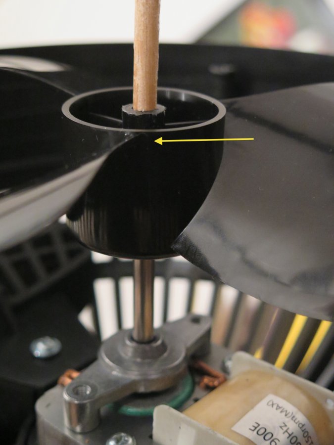

What I'm trying to do is, drill a small perpendicular hole on the motor shaft (as mentioned above) through both the motor shaft and the fan blade plastic housing so that I can thread a wire through it to hold the fan blade in place. The purpose of this is to bind the fan blade to the motor shaft.
I know i can just use a lock washer but I also have a wooden dowel placed on the other side and that too will be held in place by the wire threaded through the hole. I've attached a photo for better understanding.
It's for like a science project and i'm trying to achieve like a water tornado device thing haha :D

Good luck with your project, you should try to use a low voltage DC motor if you can get one from somewhere, since you are going to create a water tornado, experiments can go wrong and water and electricity don't mix, so beware of the dangers. You seem to have a open frame mains synchronous motor, Use RCD supply to safeguard against any possible dangers from electricity and water coming together with you in between! (You may have got a cheap battery drill for about a tenner, on ebay, and used its motor and speed control, would have been more safe, also you could have mounted the propeller (fan blade) in its chuck and would not need all that hassle any ways good luck and hope your project wins merit and proves the concept of water tornados.
Thank you for the helpful advice Mike! I haven't thought of using those appliances you've suggested so that's a really good idea. At the end of the wooden dowel I'm going to be attaching a piece of ceramic or something horizontally using a wire wrapped. And I will build a small wooden frame/table for placing the fan over it, facing it down and the wood rod with the ceramic attached will go inside a container of water and once switched on, It'll create a tornado. So to summarise It'll be a normal 8" air circulator fan with the front mesh guard removed and with the motor+fan blade I'll place a wooden dowel in the fan blade sleeving.
Also may I ask, what you meant by placing the fan blade in its chuck? Sorry for my lack of understanding haha but i'm learning :)
