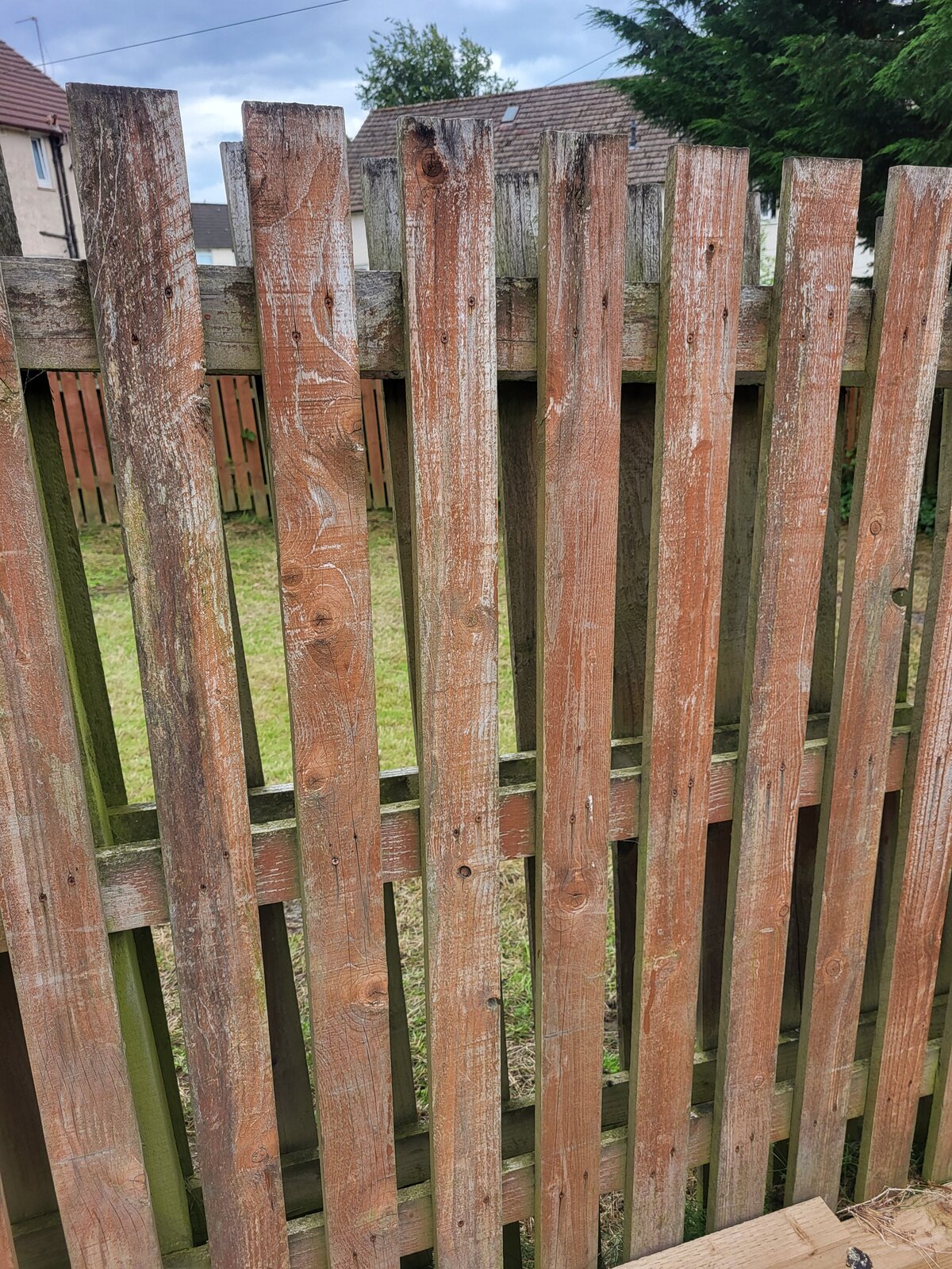

We recently moved into a new home and wanted to add some privacy and fill the gaps in between fence panels.
Does anyone know a fast and cheap way of doing this? The gaps are all different sizes. Some 3 inches some 2 inches.
I don't really want to put up a new gapless fence like some of the neighbours due to the cost.
Is there a more simple solution?
Please see picture for reference.
Thanks all

whats the wind like around that area , in garden , just in case it was put in like that other than price
whats the current wood like, rotten or all sound
has it got the same setup behind it ?
maybe just move that across - so you create a solid look
more photos from both sides and posts
The woods in decent condition. No issues with wind here, very sheltered

Has that pic been taken at an angle rather than straight on? Head on do the panels obscure the view better?
Looks like our hit and miss panels - except the gaps on yours are ginormous. Our planks are circa 160mm wide with a space of 30mm between them. On the 'other side' the gap is in the centre of the plank more or less. It can blow a hooley here sometimes.
Mind ours is also all affixed to the one arris rail from either side rather than two rails a good distance apart.
Try removing some of the planks and re-spacing some to see if the view can be made more private? Then maybe add a couple of extra planks per panel with smaller gaps?
It might be good to have a chat with the neighbours about it...
I'm wondering how easily the uprights come off?
Following Rodders53 suggestion, if they come off reasonably easily, I'd take them off in sections and reduce the gaps, adding in new uprights as you need to...
Bamboo screening would be cheap and easy. Might not be the look you're after. It could conceivably be attached with a staple gun too.
If it was me, I would grow something up it, but that's my answer to everything.
