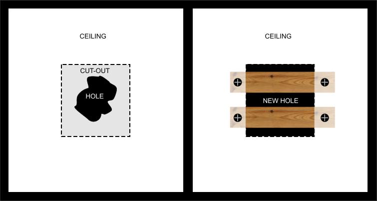

Hello, could anyone advise on how to fix a hole in my ceiling? I was removing a mains powered smoke alarm, the fixture holding the alarm to the plaster was very loose and crumbling. After removing this I have been left with a fist sized hole in the ceiling with the mains cable hanging from it.
I have read varies methods to fix a hole but none take into account having a cable to plaster around(the cable has a choc block attached for the connection to the smoke alarm).
Has anyone got a good method to fix this?
Thanks in advance for all advise.

OR...
cut out a square from the ceiling, use this as template and cut a fresh new piece, make a hole in it for the cables.
then cut 2 pieces of timber batten, put them on the other side of the hole in the ceiling to make 2 bars across the hole, screw through from the room side and into the timbers securing them in place, then you can screw your new piece of board into the 2 exposed bits of timber, and use easifill to fill out flush and sand smooth.
not sure that makes sense with just words so hope this helps!
