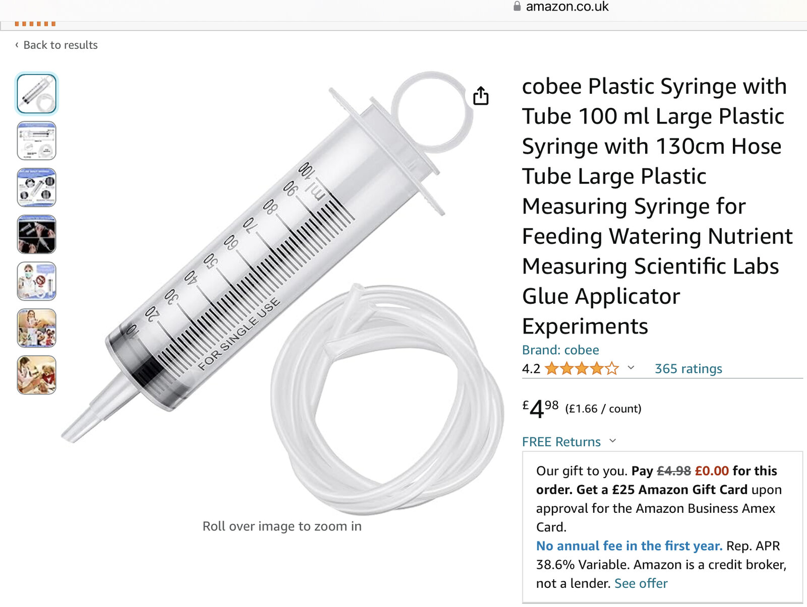

Close both rad valves on one rad, drain the rad, remove the bleed screw and use something like this to get the inhibitor in. Refill rad, repressurise system and run it up to get the inhibitor circulated. Job done. Other sizes are available but you’d only need 10 shots with this syringe to get a litre of inhibitor into the system.
No need to completely drain it, just drain it enough to leave space for the inhibitor. You can get syringes much cheaper than that.

I'll use the Rapid dose after draining the radiator a bit to allow enough inhibitor in. It's slightly more expensive but given only to be done once in a while, it's less fiddly than other useful methods like syringe and tube etc.

It can be done but is tad messy as there will be a blow back unless there is means to keep the pressure at zero typically like on a rad with two tappings. Often a towel rail is found lurking in the bathroom which is ideal for dosing the system.
