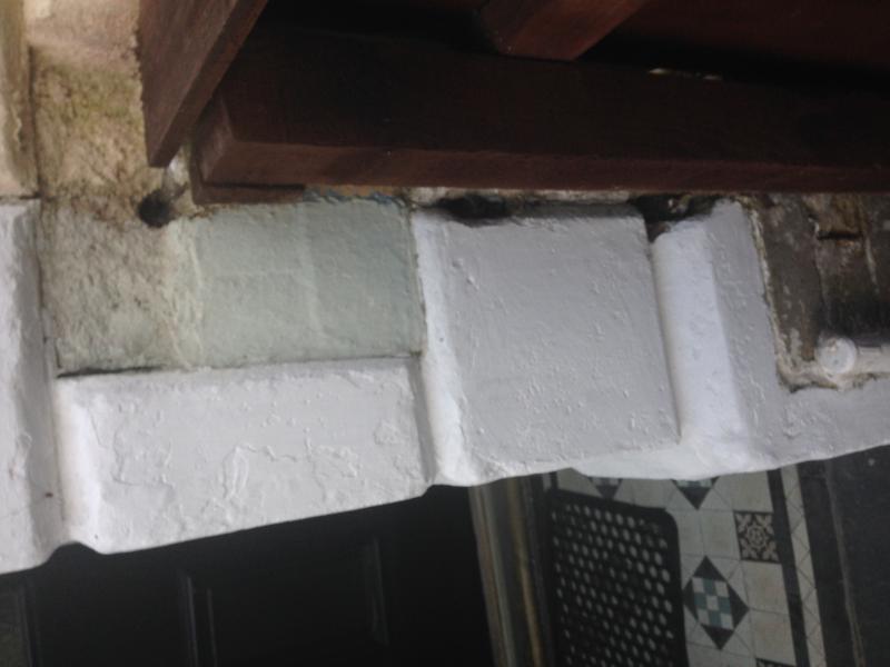

Outside the front door, there are some holes. I suspect these (well, at least the round one) are from the above work.
a) I think I should fill them, right? What should be used to fill them?
What are the considerations, ie. condensation, expansion? Use expanding foam, sand and cement? What products?

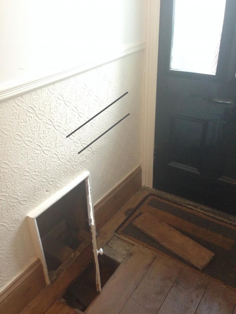

The other thing is: b) on the internal hall wall between the front holes and the old meter cupboard, there seems to be a couple of long, pipe-shaped bulges (marked in photo) - perhaps where pipes were but have been filled in? I don't know if the external hole stretch all the way through - ie. I don't know how much filling in is to be done.

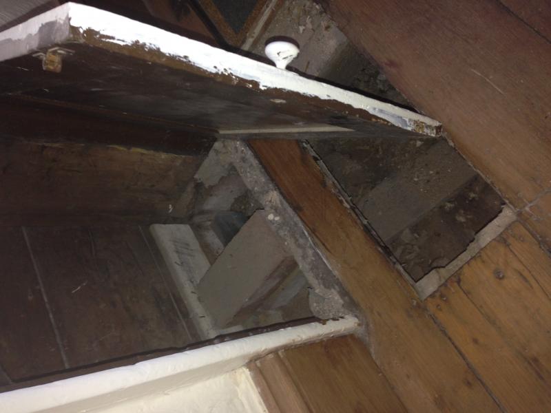

c) Also, there is an empty cavity where the old meter would have been in the cabinet, stretching under our floorboards. Should I be concerned about this, should I do anything with it?

Mice can get in through small holes, although cats often bring them in still alive and the mouse escapes and moves into your house.
Sand/cement is usually OK to fill in with.
Get a small pre-mixed bag of sand and cement from a plumbing suppliers, use it to plug all holes inside and external.
Tightly board the flooring in the meter cupboard.
Maybe, go around the outside of the house and check each air brick or vent that it is not missing or damaged?
I cant see clearly, but of more concern should be the fact that your floor joists in the hall seem to rest on the oversite soil.
Given that you have a tiled vestibule, and the hall joists run the wrong way for ventilation from the front elevation - how much underfloor ventilation do you have?
