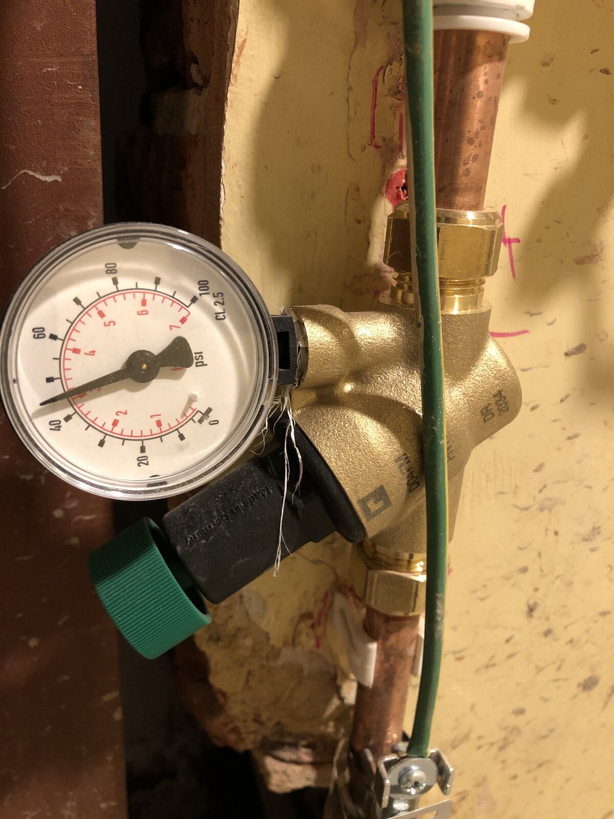

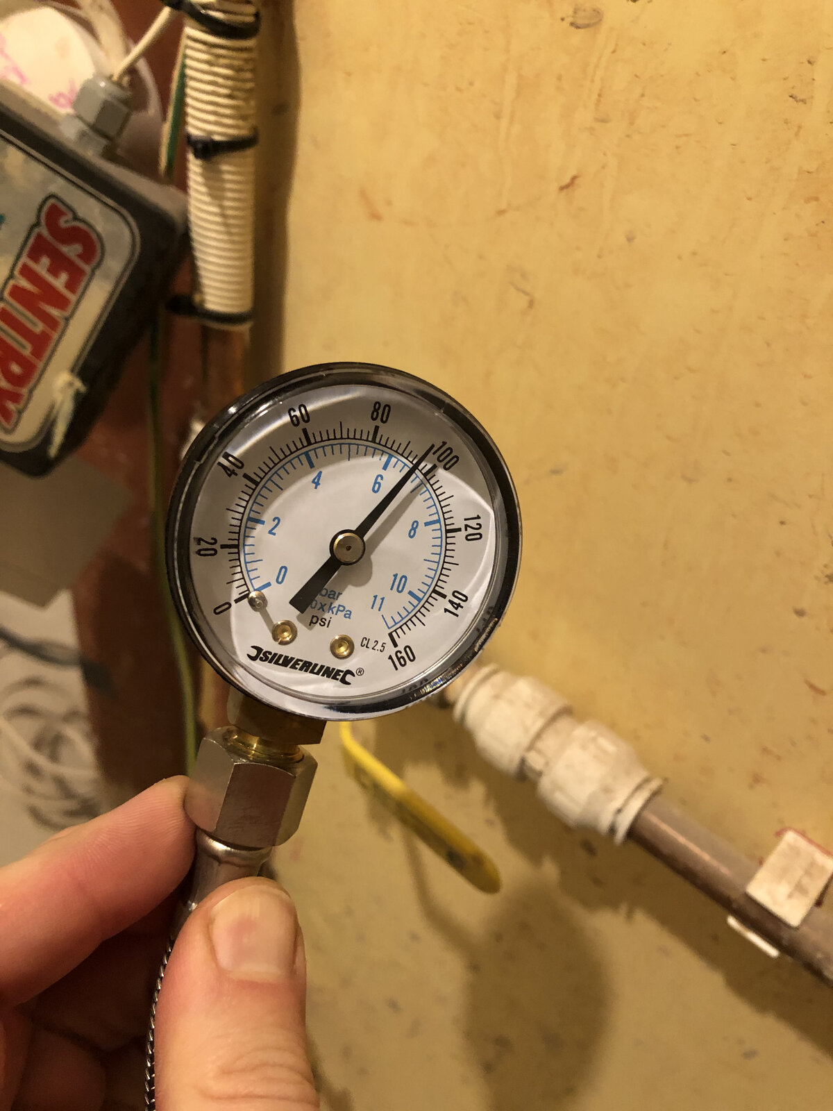

Thank you - that is a great suggestion I never thought of. There are 5 new houses that have just been built directly opposite our house and people have moved in about a week ago so that would make sense. I haven't got a pressure gauge but will pick one up from Screwfix and see what it says. I'm assuming by your post, if it's above 3 bar then fit a PRV and reduce to 3? Thanks again,
Yes, that would be the ideal. If you still get hammer after that point then I'd advise looking at what's creating it rather than an arrestor to 'hide' it.
Great advice re pressure. Pressure gauge arrived today and shows between 6.5 and 7.5 Bar (changed a bit each time I tested but never below 6.5). So off to buy PRV tomorrow and hopefully that’ll fix it. Thanks again.

Thanks again - going to try PRV first today (and will have to close stopcock for that anyway so will try that at same time) and if that doesn’t work I’ll have to trace the pipe and clip any bit that looks a bit shaky and hopefully that’ll sort. Thanks.
PRV fitted in about 15 mins. Adjusted to 3.0 bar. Water hammer gone!
