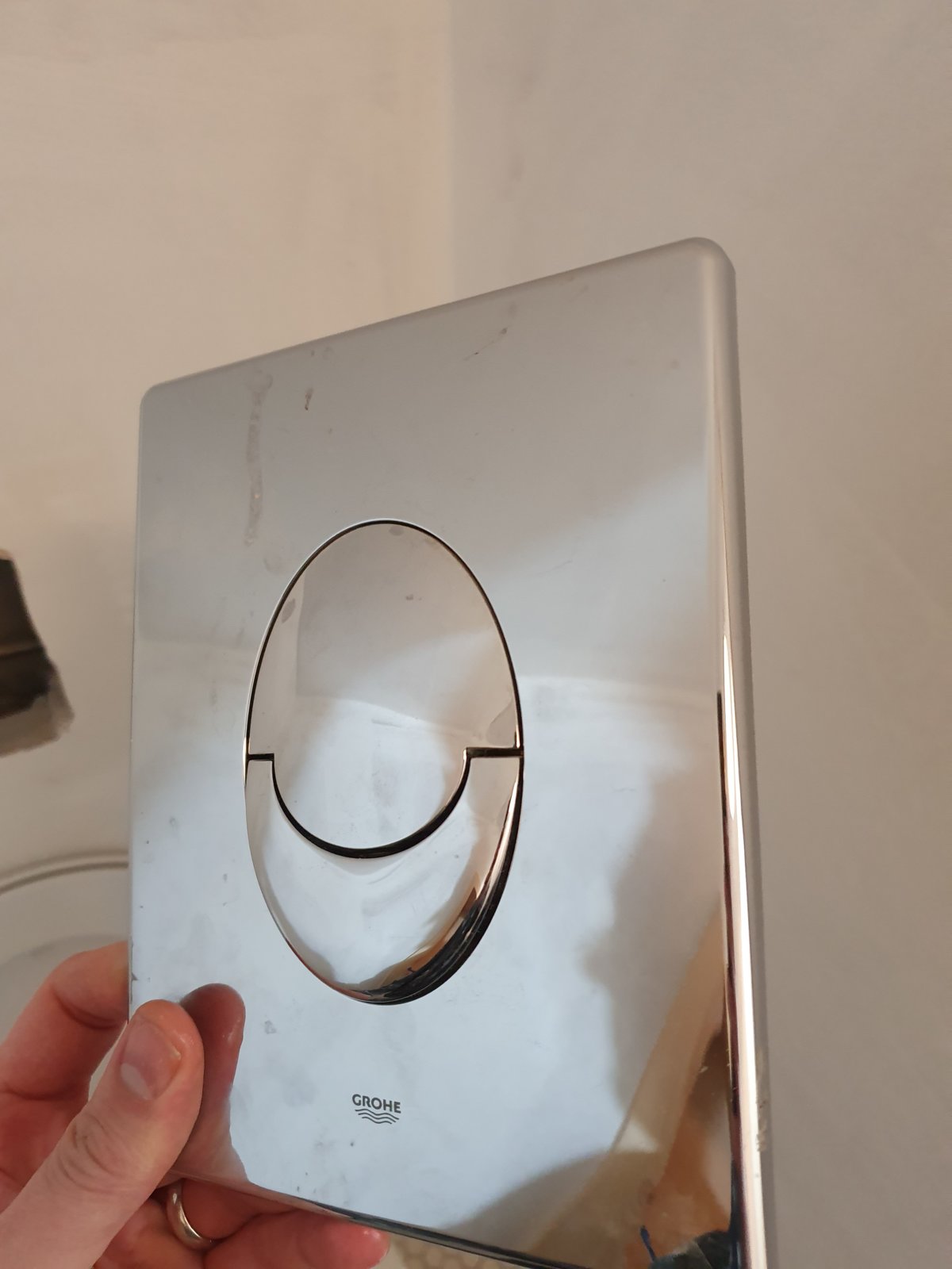

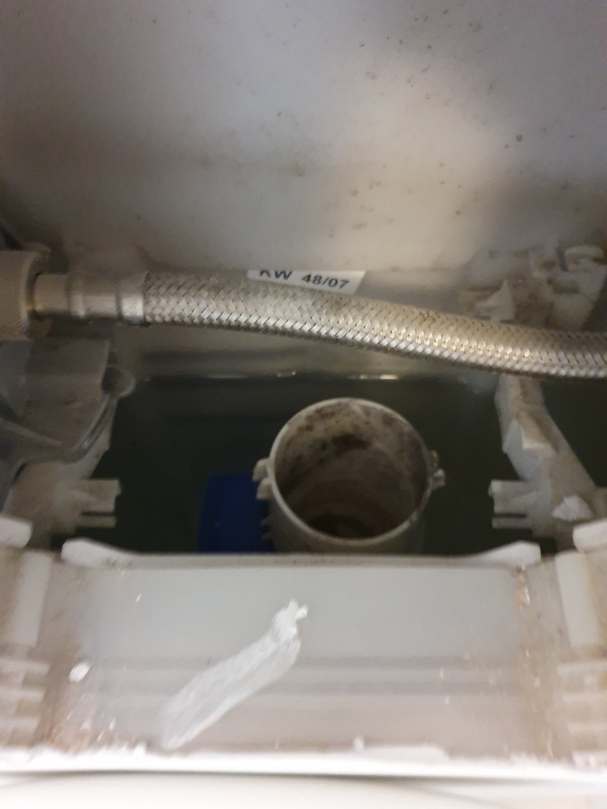

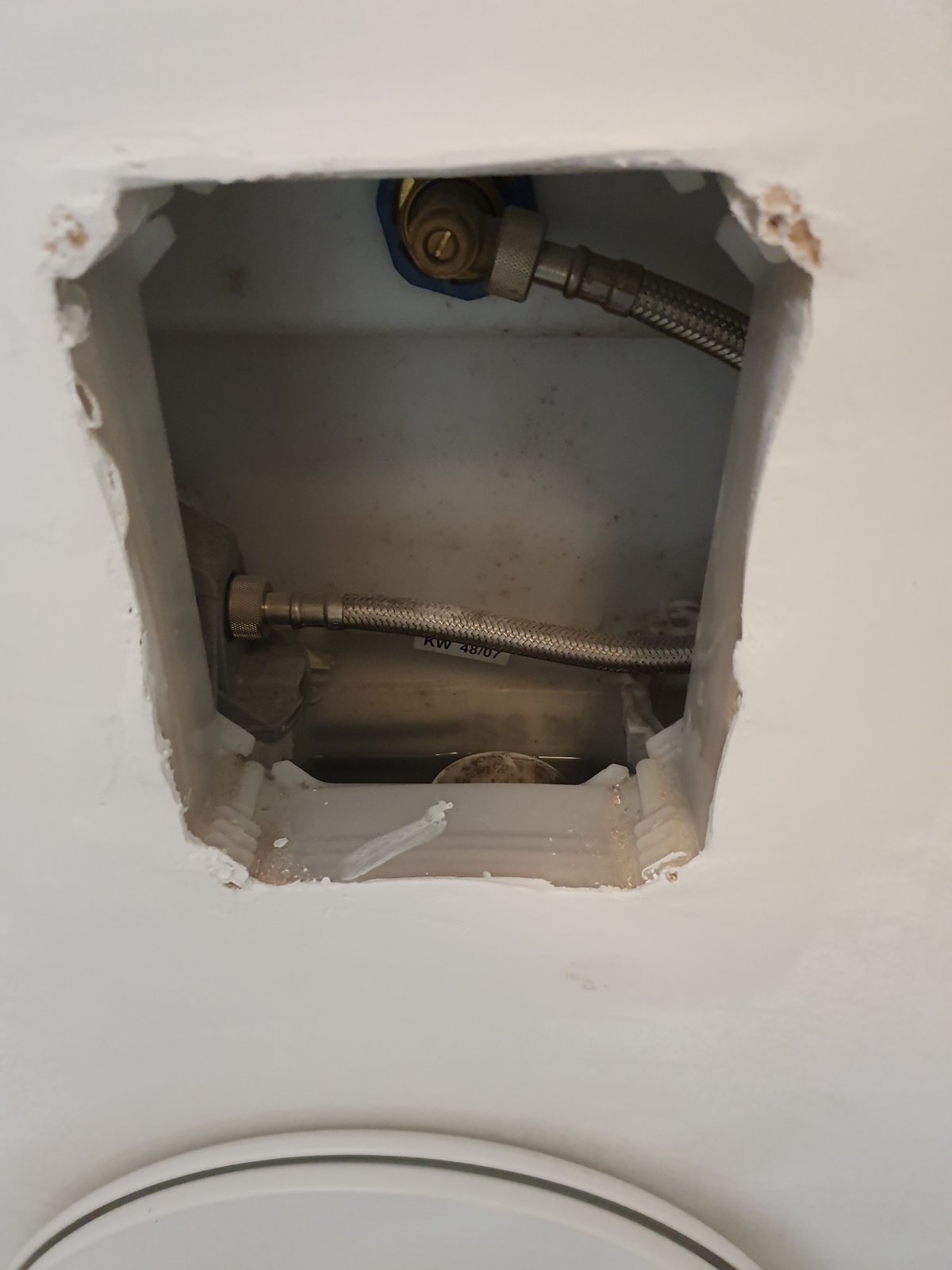

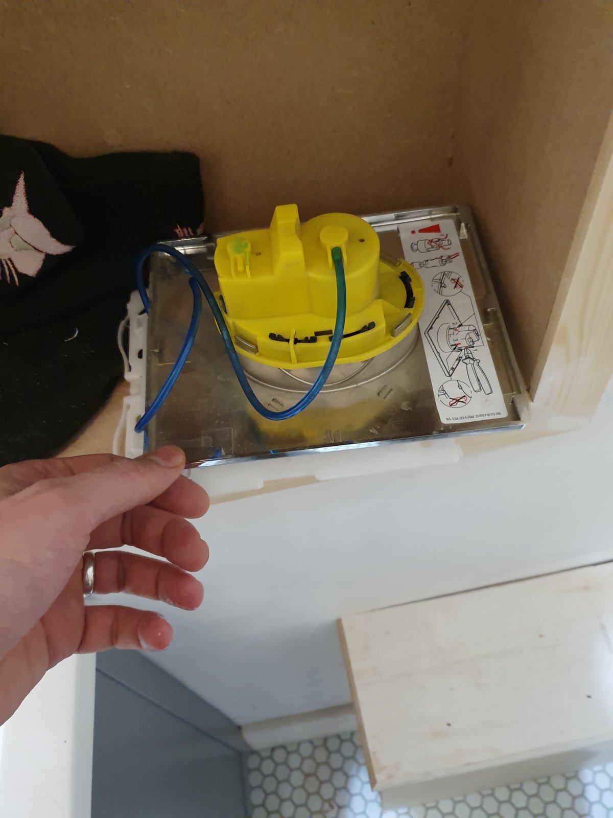

I've got a Grohe wall hung toilet flush. Plasterers recently removed the wall plate for the flush and now that plastering is done I want to put it back on. The problem is I cannot work out how it goes together.
Has anyone fitted on of these before? I think when you press the button it blows air down the blue tube (see the photos I've uploaded) but I can't see where you connect this tube into the cistern part
many thanks for any help

It would appear that they should have been left connected? You might have to remove the flush valve, but maybe contact Grohe?
https://www.grohe.co.uk/en_gb/our-service/installation-videos/install-wc-solutions.html
Hi
You're right they should have. Contacted Grohe and they were pretty good. In case its ever of use to any one else, you do indeed have to pull the flush valve out. It feels like you're breaking it when you pull it out - you done unclip anything or whatever, you literally just pull it up with a bit of wiggling until it comes away.
The tube then connects to the bottom of the flush valve.
All done and working now
