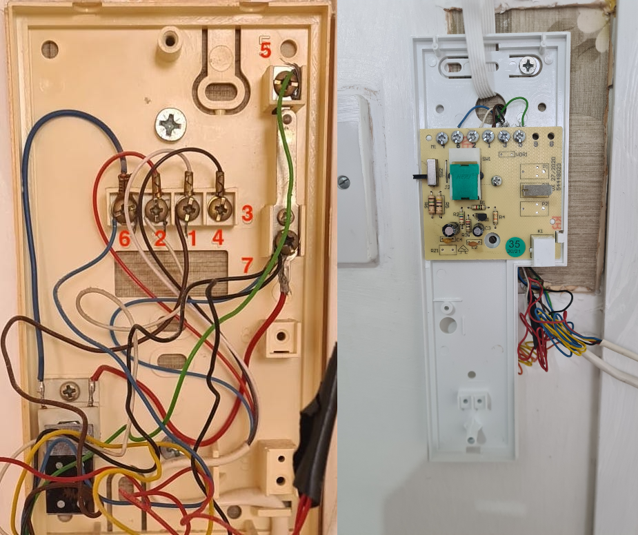

Buzzer not working following Videx Smart 1 replacement from Videx 3011​
I have replaced my old Videx Smart 1 with a Videx 3011, unfortunately, the buzzer no longer works.
Videx Smart 1 was connected to an AC buzzer the Videx 3011 I understand has a built-in chime/tone.
Any suggestions on how to make it ring again?
Everything else works audio and door release.
Remove buzzer from old handset and wire to 6 and 3
Or fit the correct handset with AC call
Thank you for your comment.
The buzzer was an external box huge and with an annoying sound. `Is there a way to bypass the old buzzer and use the internal chime included with Videx 3011 ?
