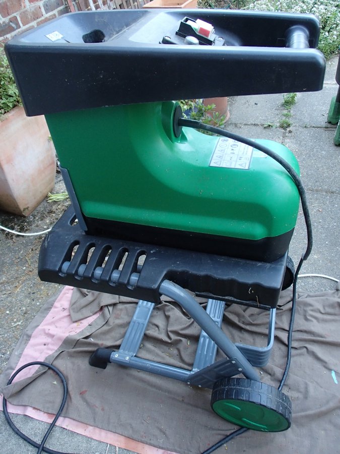

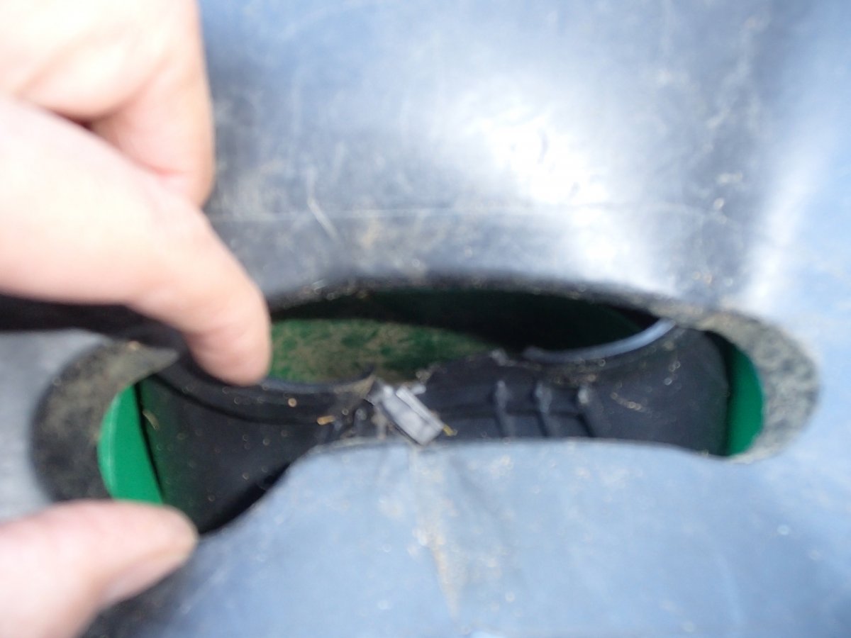

A branch with a side stub dragged the lower part of the hopper in.
In the photo, the bit my first finger is pointing to should be tucked under the piece my thumb is on.
Anyone know how to get the top part of the hopper off so I can straighten out the lower piece?
Mary
I would expect hidden screws holding the black top on from underneath
That's what I thought, but couldn't see anything. I've taken all the other bits apart - but nothing revealed fixing screws for hopper.
Curious. Can only find a serial number, no Maker's name or Model Nr. Did find identical shredder in a YouTube vid called 'European 2400W'.
Also found an Aldi Gardenline which looks v similar (the collection box is a different colour) but can't find any diagrams for any of them.

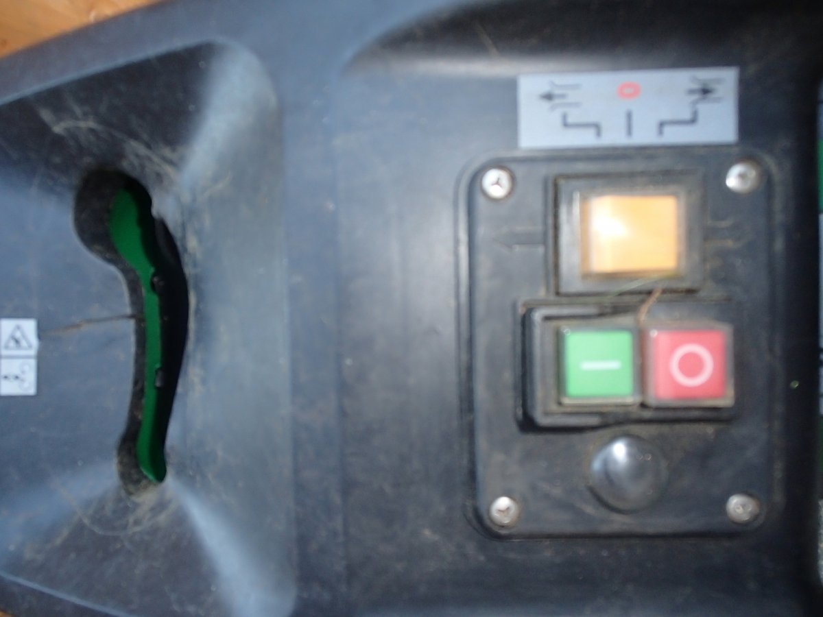

There were 4 screws I didn't undo as I assumed they were just for the control unit, and they require a tool I don't have (funny 3 sided slots on screw head).
Could that be holding the black top on?

Tigercubrider - yes, you are right. There are (very) hidden screws. I took it apart again and found them. Now I just need a 25cm screwdriver!
Thanks for your help:)
