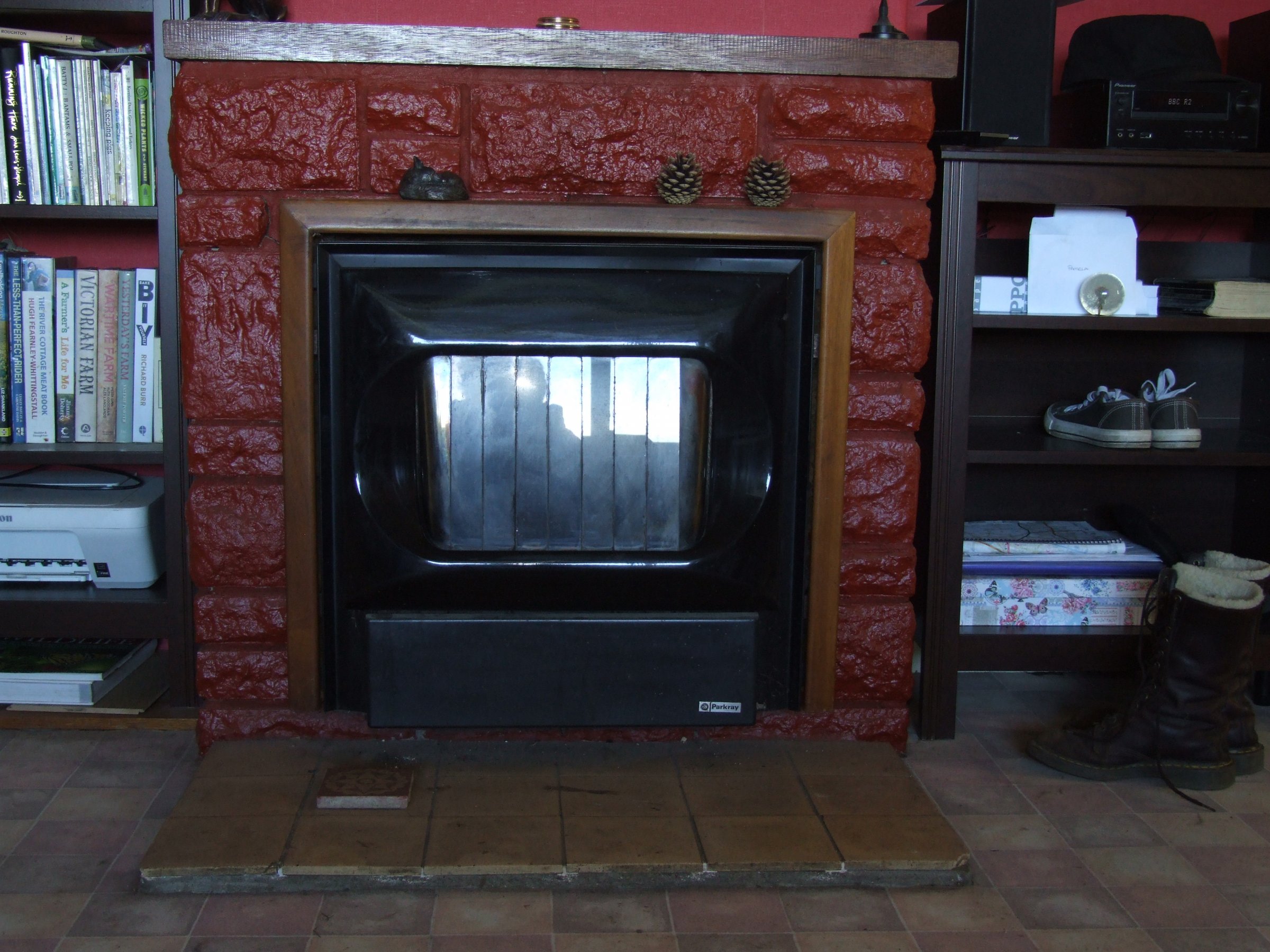

Hello all, I know there are lots of posts about opening up fireplaces, but I would like to know if a: It is going to be fairly straightforwards to remove this parkray burner out, and b: if the fireplace integrity will be unaffected? I'd like to remove the brick surround and the hearth tiles to find out the actual size of the real opening. We would like to put a wood burner in there and wish to do as much of the work ourselves as poss to save a bit of money. Thanks in advance x

The Parkray can be pretty heavy to slide out & remove.
After removing everything back to the old fireplace opening you should call in a HETAS for at least a safety heads up before attempting to install anything else..
we are so far out of town that there is NO gas supply here anywhere. We are not even on mains drainage. :) The airing cupboard is next to the fireplace and there was a stone surround between it and the fire. We removed it and there are no remaining pipes, the boiler is run by oil these days.
Never cap off any pipes still connected to a boiler or heating appliance. You cannot guarantee all the water is removed, and should someone light the fire/turn the heat on, any trapped water could boil, turning the boiler/appliance into a potential bomb
