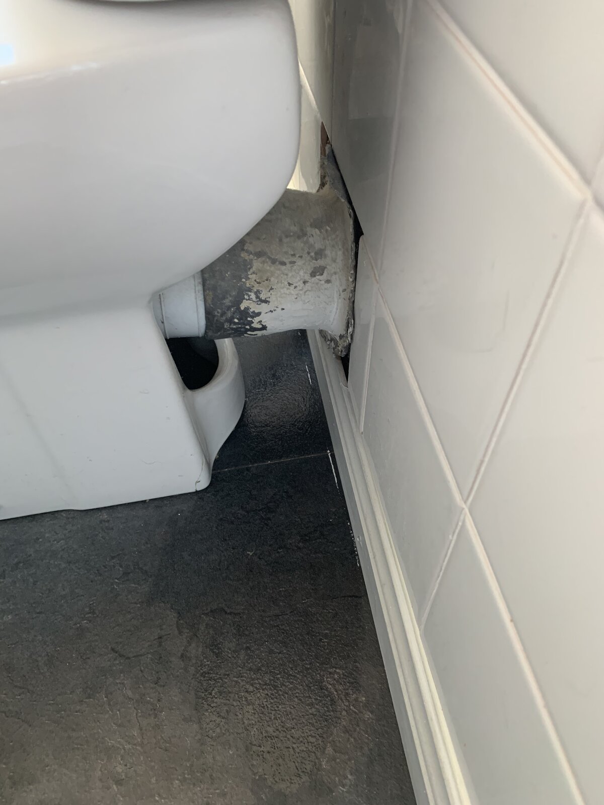

Hi,
I’m planning to sell my flat soon and want to spruce it up a bit for viewings.
When I moved in I had planned to renovate the bathroom completely and due to one thing or another I haven’t managed to.
I’ve now decided I want a bigger place so I’m going to sell.
The soil pipe on the toilet being exposed has always bothered me because it looks terrible. So looking for a cheap and simple solution to take the eye off it. Ideally a premade cover that I can fit easily (I’m not very handy). The bathroom work is shoddy at best - I suspect most of it was a DIY job. So I just want to make it look a bit better for prospective buyers, who I suspect would want to change the bathroom anyway.
Any help appreciated, thanks

You might also want to squirt some expanding foam in the gaps around the soil pipe. Let it cure, cut it back and then put some lightweight filler over it (eg Red Devil) and then paint it at the same time as painting the soil pipe.
