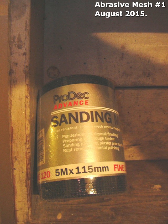

Following your post, I've attacked the wall in question using a piece of abrasive mesh (see photo) wrapped round a hard plastic sponge and kept wet.

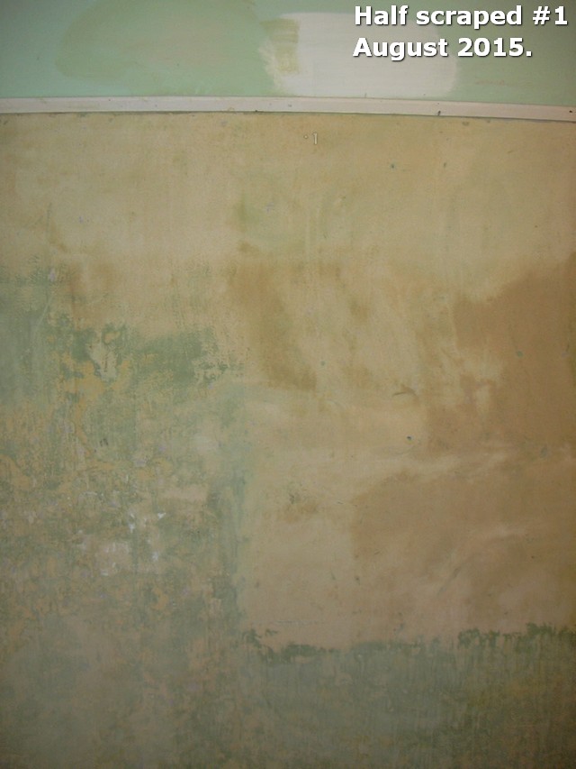

The results, so far, are shown in the next couple of photos:

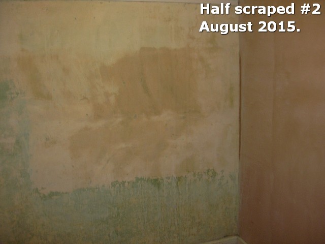

and
I had to keep washing off the debris with a wet sponge because the debris obscures the progress. I was pleased that I was getting back to a smooth plaster surface. I'll have to revisit to deal with some of the obstinate spots.
One of the photos shows the wall above the picture rail - that's a whole enigma of its own, I think it may be eggshell paint!
I hope the photos come out - I can only see thumbnail images as I type this!
