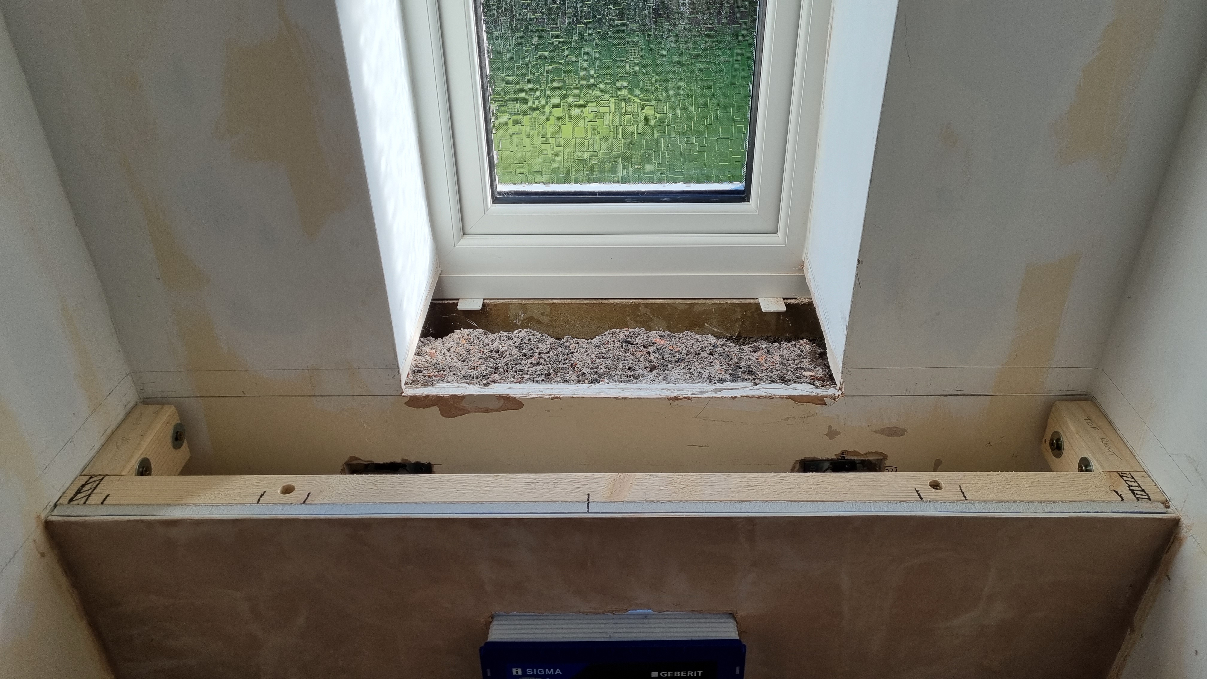

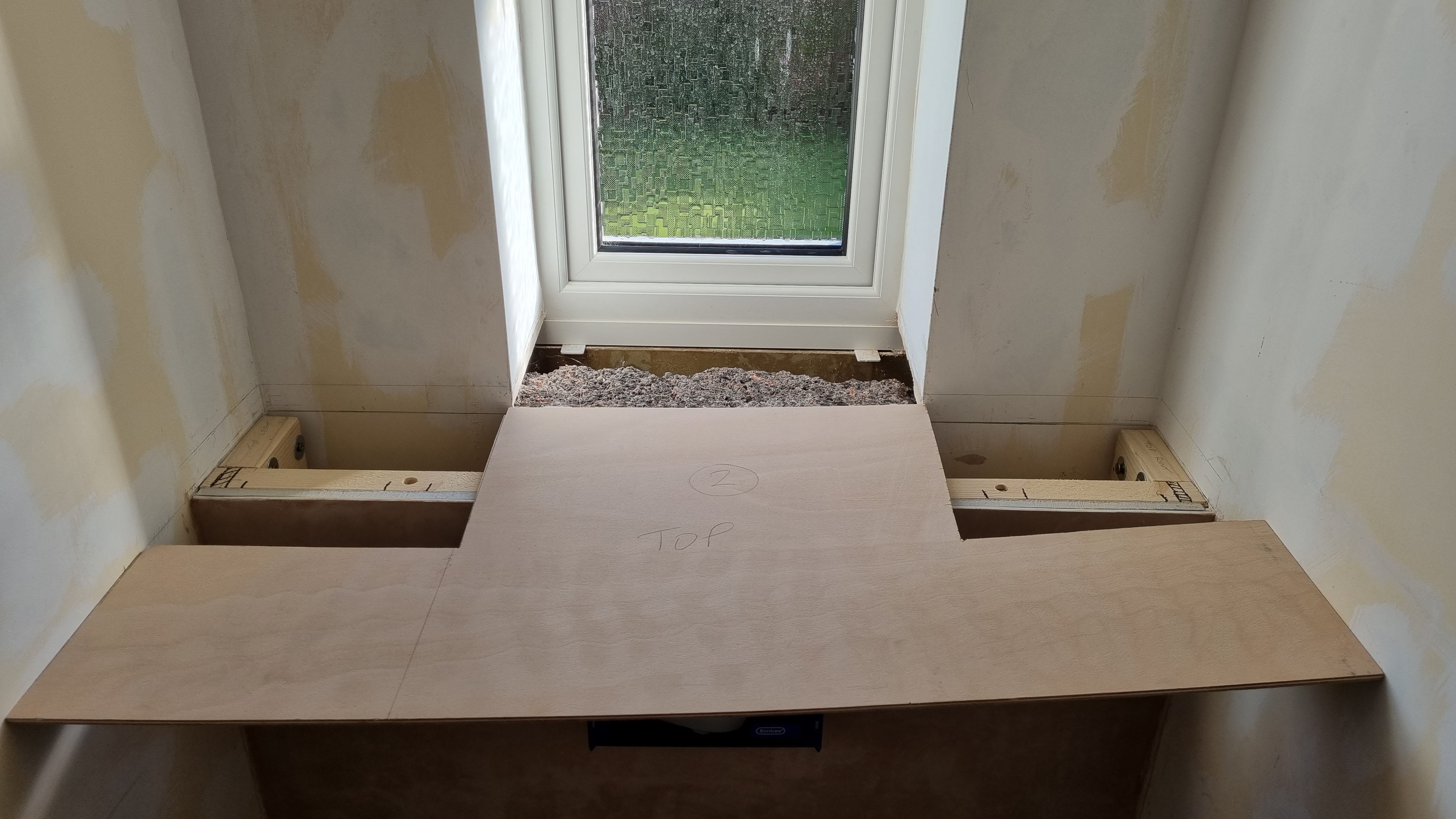

As part of my toilet refurbishment, I plan to fit a 32mm thick oak shelf.
Against an outside wall, with a window reveal, I have already installed a Geberit toilet frame and boxed it in. The top of the boxed frame is level with the window ledge, so I plan to cut a piece of oak wood to fit into the window reveal and out to both sides of the narrow room.

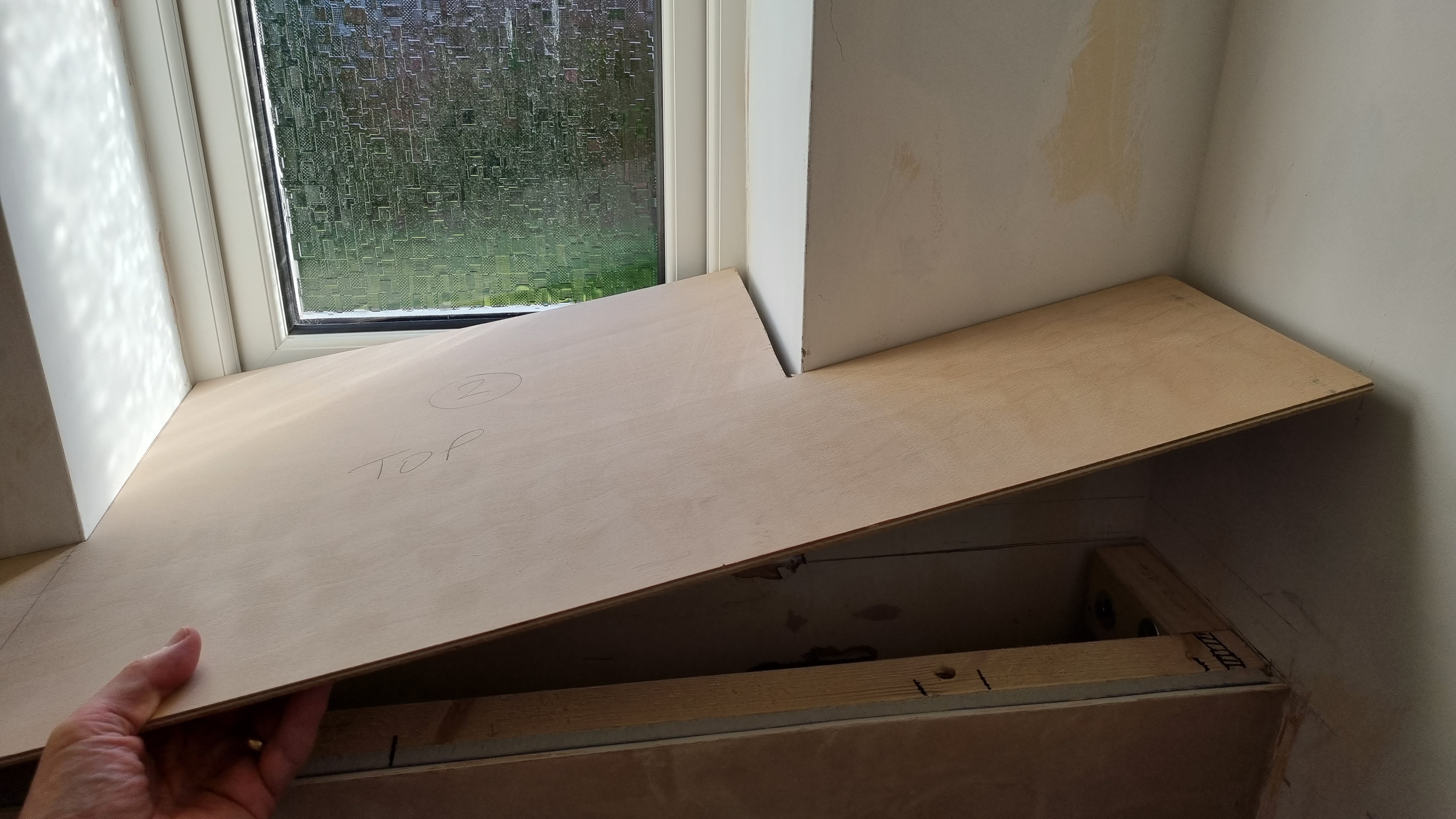

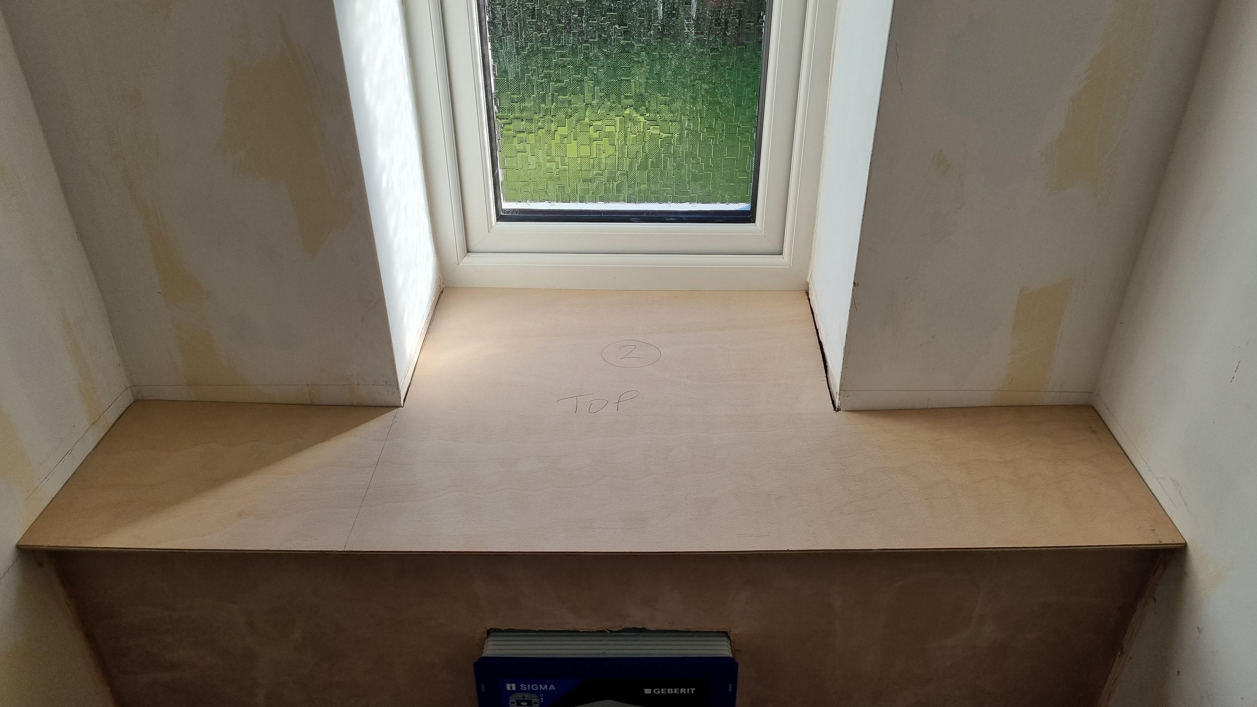

I have used some plywood to create a good tight fit, which I will use as a template for cutting the oak board.
The issue I'm having is that the back of the window reveal is 1cm wider than the front. This means I can't just position the shelf horizontally and offer it into the reveal as it won't fit. Instead I will need to angle the shelf and put one side against the side wall, then lower it into position on the other side wall. This is easy enough with a piece of 6mm ply, but it probably won't work with a piece of 32mm rigid oak as the thickness will add width to the shelf, meaning I probably won't be able to lower it into place.

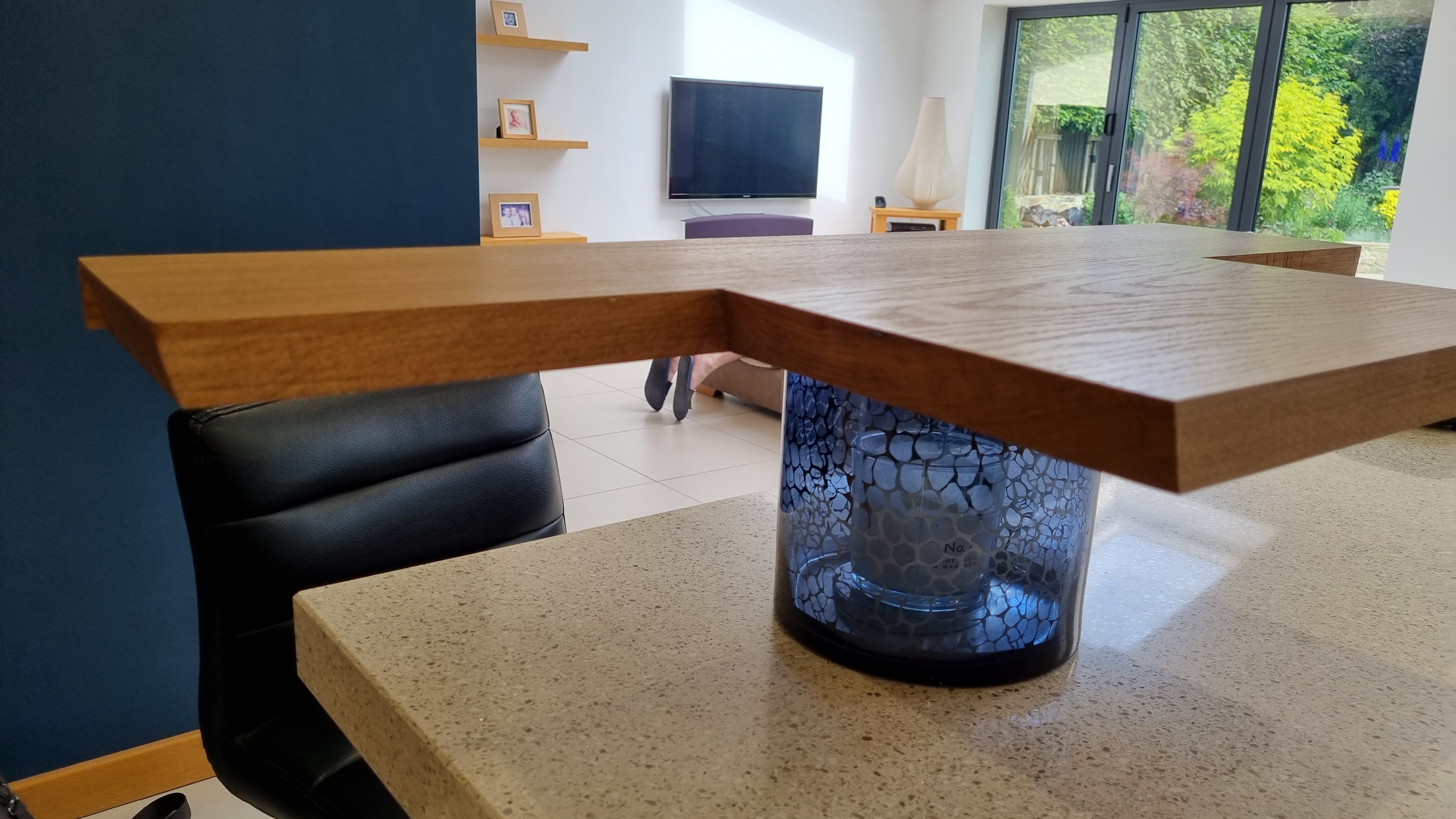

The obvious solution is to cut the shelf width slightly less than required, but then when fitted I will have a gap rather than a nice tight fit upto the walls on either side.

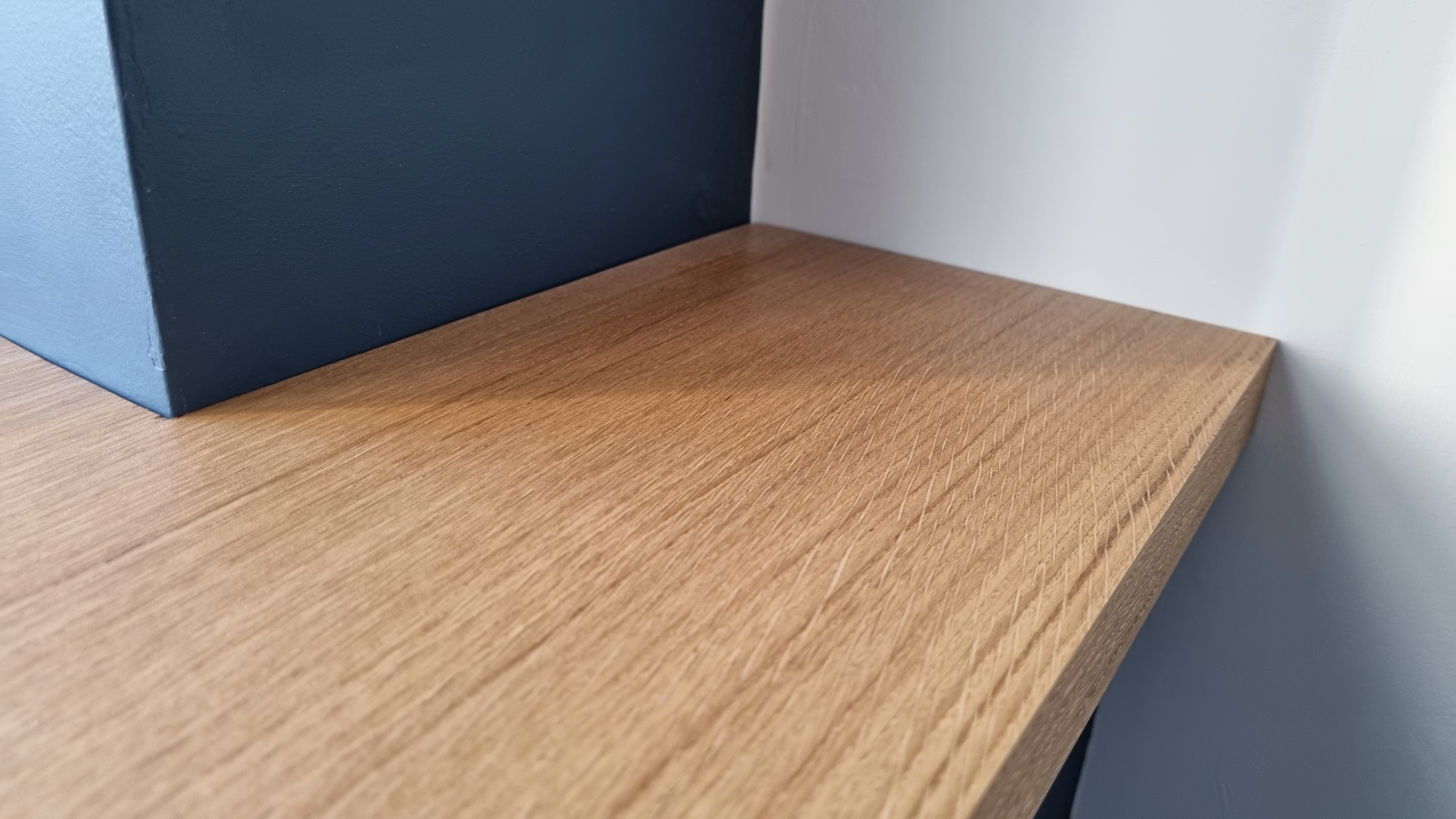

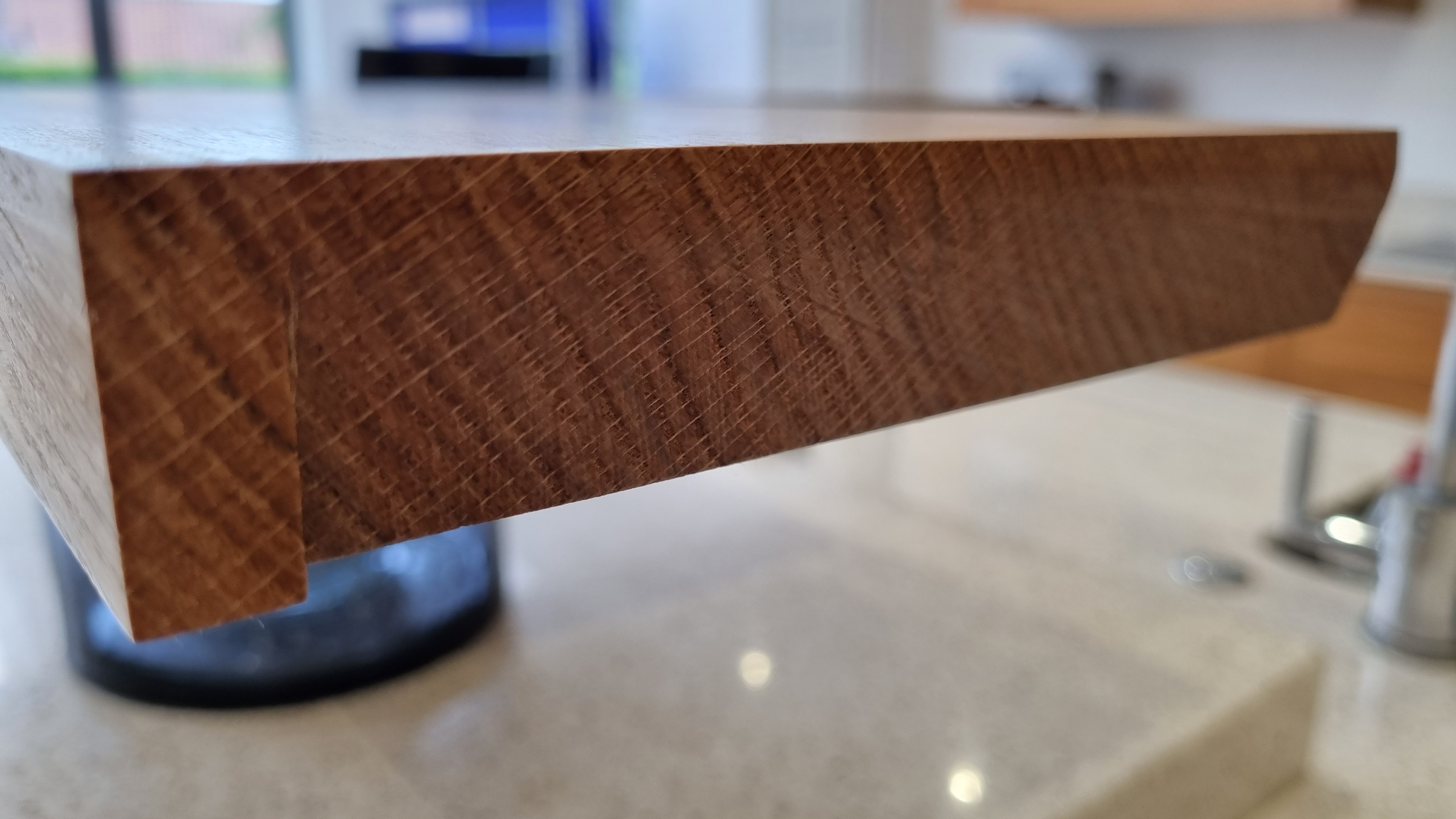

Another thought I had was to cut through the thickness of the shelf at an angle, so the underside of the shelf was narrower than the top side. When the shelf was angled, the top and bottom of the shelf would be parallel to the wall and only when finally in position, would the widest part of the top face of the shelf actually touch the wall. This would work perfectly for the window reveal and all but the front face of the shelf as it would be possible to see the angled cut from the front and I don't want that.
Any thoughts on how I can go about fitting this thick shelf and get a good tight fit?
