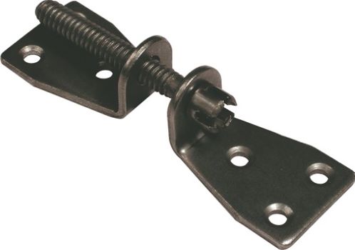

There is an alternative to the "traditional" routed-in dog bone worktop fasteners. Solmer sell a surface mounted worktop joiner:
Personally, I think I'd add two or three of those to the joint, regardless of what IKEA say, I'm not at all happy with just depending on silicone to keep the joint tight (you're right, it is very cowboy-ish). At 28mm (thickness as quoted in the link you posted) the worktop is thick enough to take dog bones, but those do require a router and a jig (or a joiner) to do the cut-outs whilst the Solmers don't. The Solmers, like all worktop joiners, require the tops of the units you are resting the worktop on to be dead flat, which should be a given in any case
