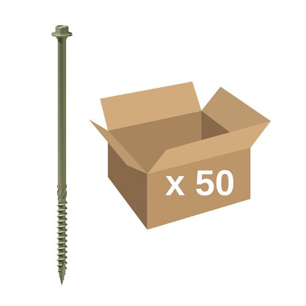

Are dowels a good idea to join top and bottom? Any tips for marking out?
Finally any alternatives to these special screws? Or is it just a matter of finding a cheaper supplier?
I used those type of screws when doing some edging in the back garden, think they were 10 for £10 but well worth the money!.
Found them for 45p each (150mm) if I get 50 - which is about what I'll need so will go for that.

Thanks for the tip - 250 is really long - what depth into the timber do people aim for? 50mm? 100mm?
I was joining sleepers stood on end to make a wall so the screws go through the 200mm width of the first sleeper and fix 50mm into the second, the head just sinks below the surface on the first. Gives a proper fix. The length you need will depend on which orientation you're fixing them.
If you don't have one, consider an impact driver, makes screwing them together loads easier.
Not the same but I used scaffolding boards (225x38) and timberlok screws (100mm). I lined everything up and predrilled the holes so the screws would go through the centre of the thickness of the boards, and evenly spaced out three screws per corner. I used butt joints. It was sturdy enough that I didn't bother with stakes.
