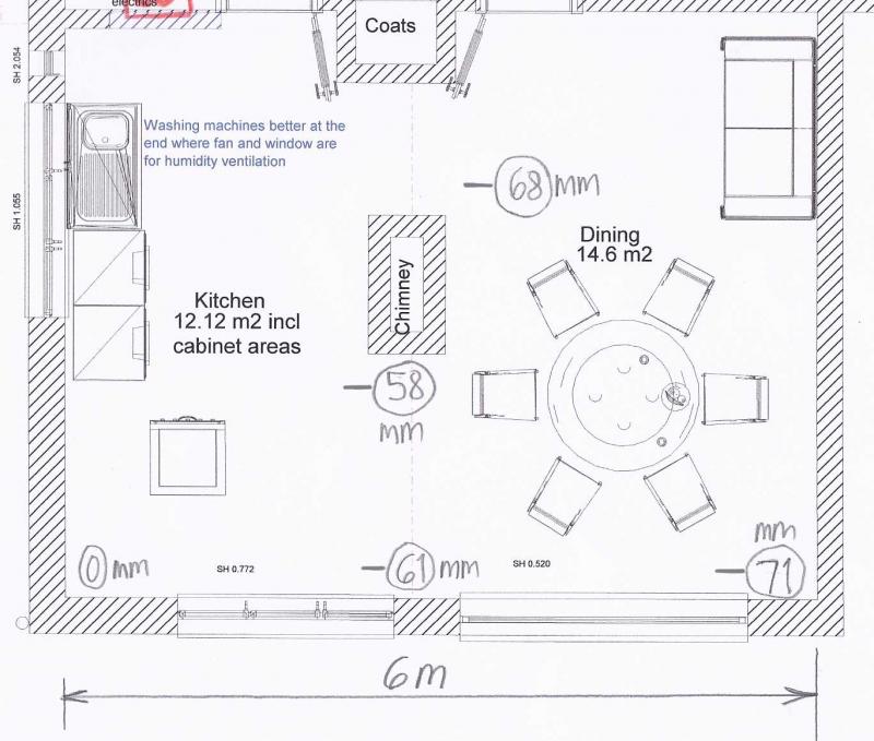

Hello,
I have stripped a floor, which is not level. As the picture shows, the difference in level can go from 0 to -71mm, with the area on level 0 being the most different one from the other areas. The floor is made of concrete and old. I do not think there is damp in the floor but I could check (it's a 60's house). Can people recommend the best way to level it? Would it be possible to blend the 'filling' on areas having level -58/-71 with the areas having level 0? I really would not like to remove the old floor. I thought of building up the level with concrete in the worst areas and then finishing the blended level with the self-levelling stuff. I am fixing tiles in the kitchen area and laminate flooring in the Dining area.
